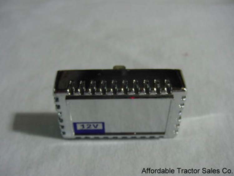

Where's the voltage regulator on my 224?
/ jinma 224--clock went nuts #10
