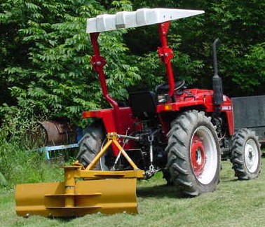

Let us know how you like the 184. I have a 224 and it is really a workhorse. Keep us posted.
John K

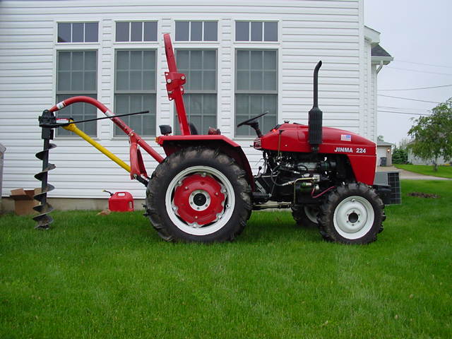

I have the 224 with the 2 cylinder. When I use the 9 inch auger I just let her idle at 900 rpm's and it has dug me almost 100 holes and never bogged the tractor at that low an RPM. It did snap a lot of shear bolts though.
