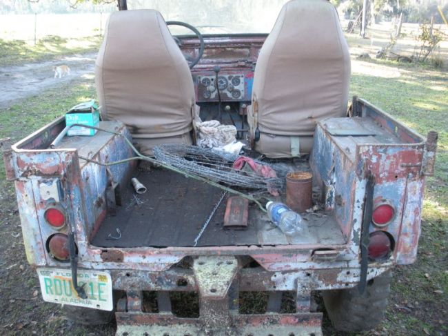

I think the fellows are leading you in the right direction. I can't add any help here.
I don't have any working lights on my jeep we use around the farm.

I am always surprised when I see a Jeep without a roll bar or cage. We used our a lot off-road,. Never did roll, but always had that cage there...
They look naked without :D
