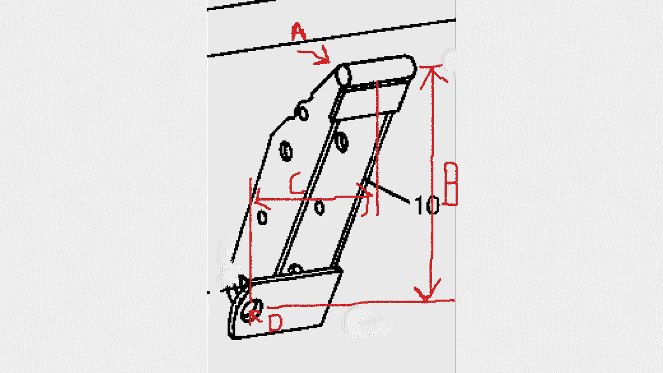

would somebody give me the dimensions of the jdqa hook in relation to the pin both vertical and horizontal? Also the width of the hook. I would like to build this to work on a Ford 1520.

Anybody living near Palmyra, Pa allow me to come over an take measurements myself?

To be more clear these are the dimensions I am looking for.
A: Diameter of round bar
B: Center of round bar to center of hole D
C: Center of round bar to center of hole D
D: Diameter of hole D
Tom
/ jdqa dimensions #4
Octo, there is no print for the JDQA that I am aware of currently, but I am working on one with another member. Please understand this was measurements taken from a loader, not anything from mama deere. Please verify them for yourself if possible, maybe at a dealer on a Sunday.
Here is what I can offer so far:
A-1.181" or 30mm
B-14.189" or 360.40mm
C-I don't have that yet firm, but from the other measurement I have it "should" be 3.327" or 85.5mm
D-1.299" or 33mm
Most guys already have the tractor side, and just use that to mock-up the implement side.

Ok, thanks I can work with these numbers. I have Ford 1520 and a Deere 855. Neither have quick disconnects. This system seams to be really easy to make and keep attachments close to loader arms in order to maximize lifting power.
