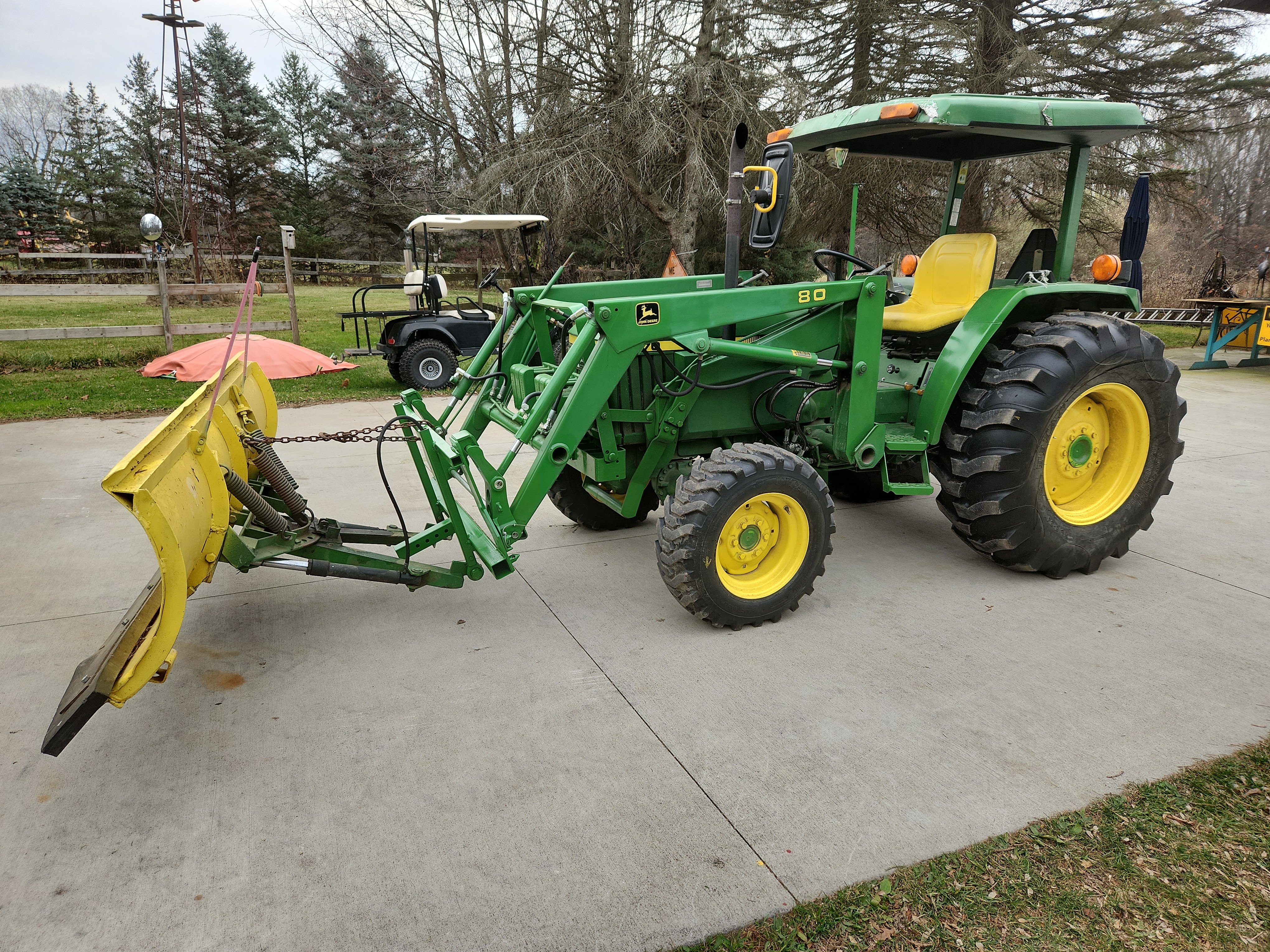

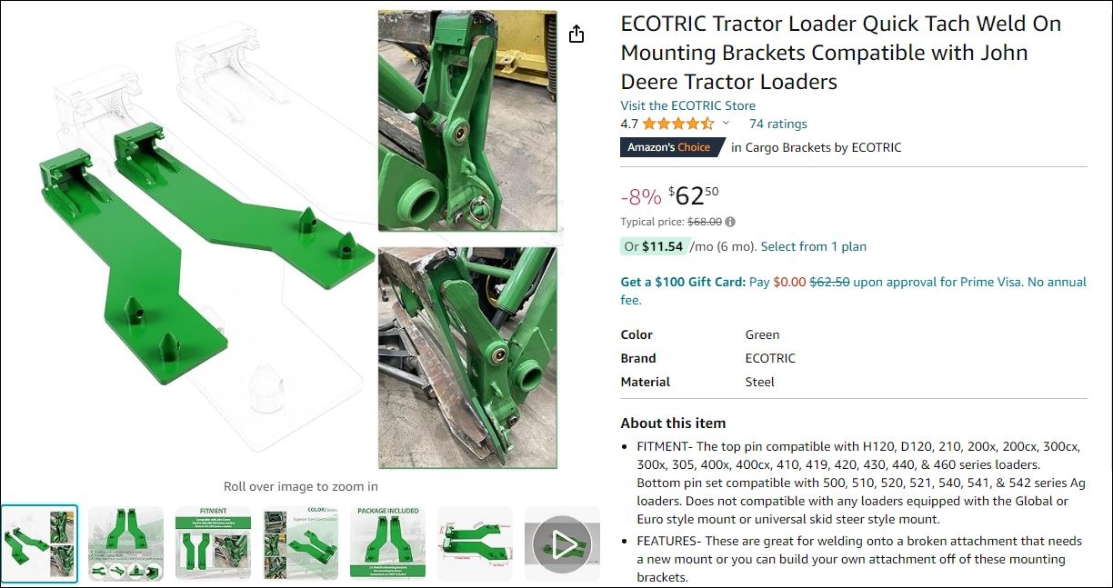

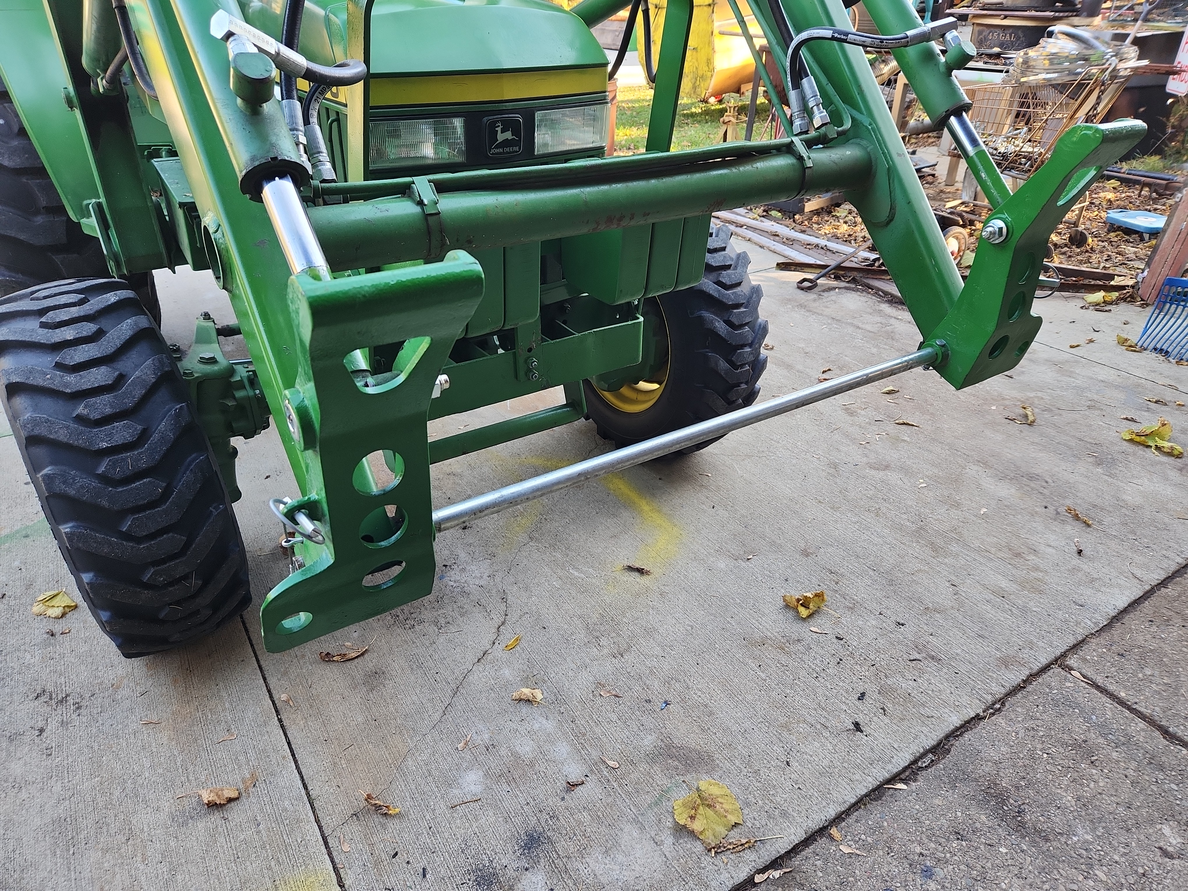

Switch the couplings so that curl and lift are swapped. Then see if lifting the loader arms is a problem and curl is now ok. That should isolate the problem.

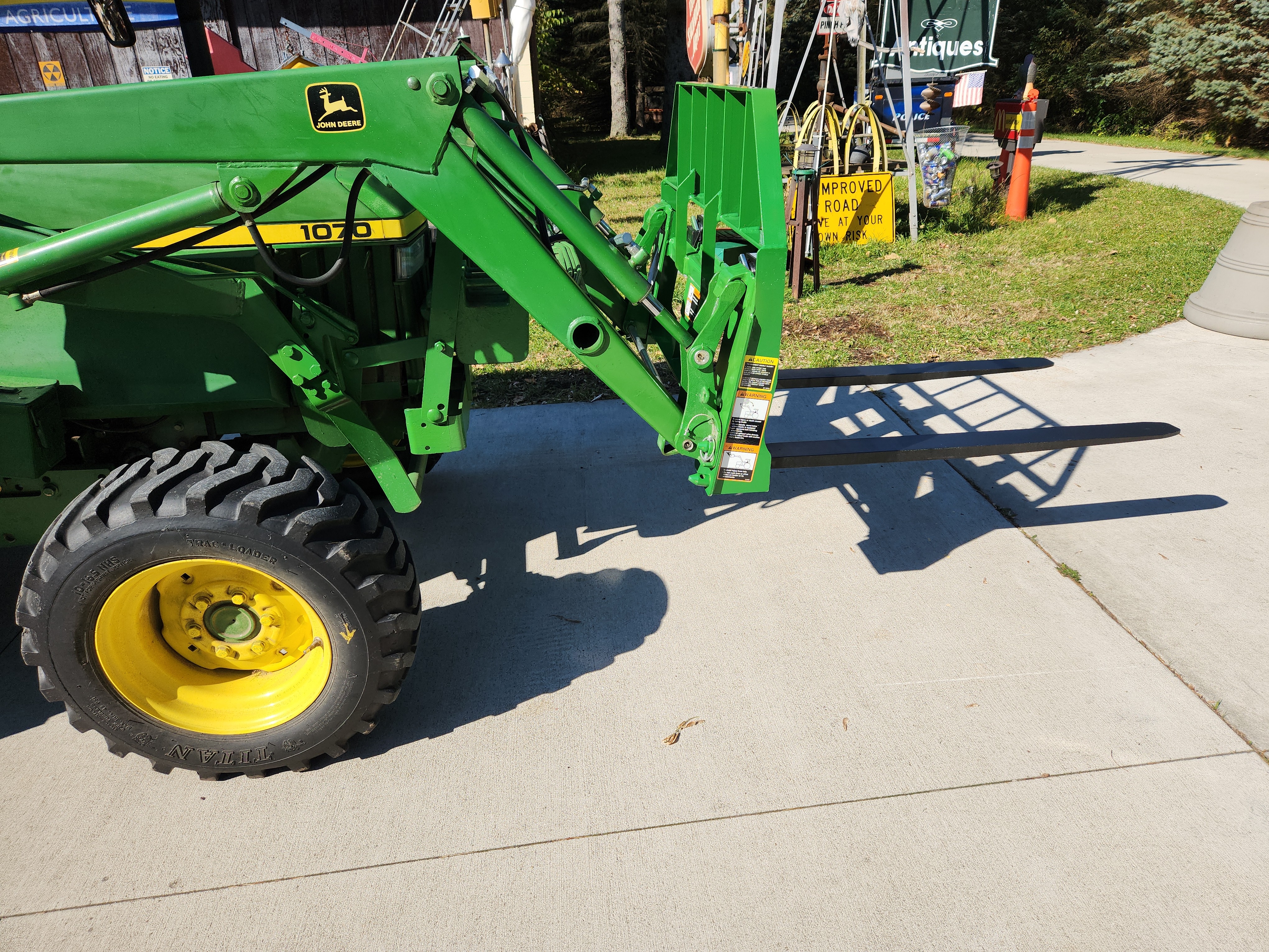

BTW: I found that it was an easy conversion from the 80 loader bucket pin mounts to the JD QA system. Even the bucket lever indicator swapped over. I bought the QA bucket (but the brackets could have been swapped out), forks, snow plow, a grapple and a tree puller that really changed life around here !

Okay--thanks for these initial thoughts, guys. I will try to devote some time to looking into it in the next day or two. zzvyb6 -- nice on the QA mounts! I never take the bucket off as I only have three-point-hitch equipment otherwise--including the round bale spear--so I doubt I'll go the extra mile but that is a nice deal. And do I remember seeing a photo of you hauling a haywagon with a Corvette years ago? I am thinking that was you....
