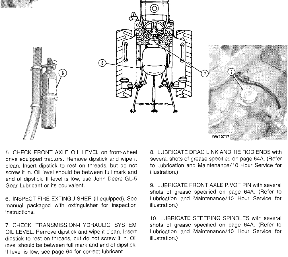

I am not sure of the proper check on the fluid level but its the same as it has always been after 7 years. The dipstick screws into the trans so I check it by screwing the dipstick all the way in..
The dipstick should not be screwed back in to check the fluid level. Just wipe it and set it back on top of the threads. Page from 750 operator manual attached.
