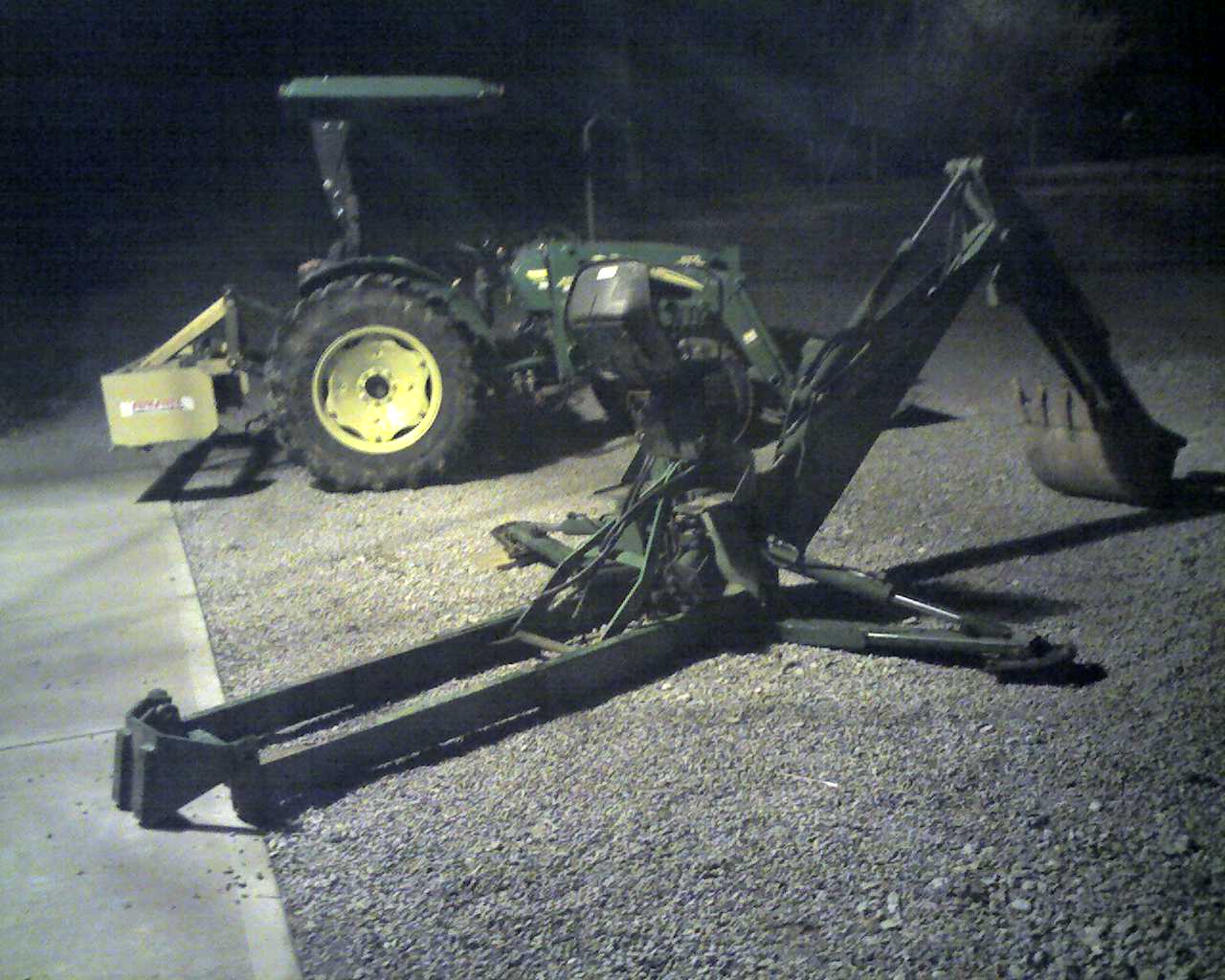

I am setting up this tractor to do alot: remove stumps,roots,trees from edges of crop land and where I had timbering done. To maintain ranch/yard/pastures/fence,gravel roads. Use to excavate and landscape this property, more buildings going up and a house. Help recommend to me the best attachments for this JD5105 tractor. (Has JD512 Loader w/center scv joystick). (--In the process of mounting a 10A backhoe, and adding power beyond and 2 extra scv for the rear-). Backhoe will not always remain on tractor. Will be a challenge to add support and hangers to fit sub frame to tractor with proper support.
What I need to know: Attachments other than these, and how best to fit them to this tractor. - 1. Center hyd ram for the 3 point. what size and where best to buy? - 2. Grapple Root Rake, so many to pick from. What works best here for my needs listed above? Need to rip and tear roots and stumps out to be able to farm the ground afterwords.

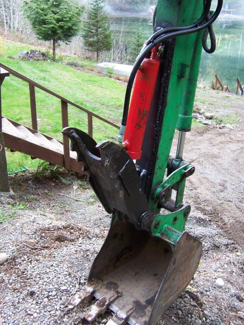

Is this what you speak of ? And any suggestions where to buy and best way to mount it. I do want to buy one of these to add on to the 10A hoe i have.

That's not it, that's a thumb. A ripper takes the place of the bucket and is used to cut through and rip up the trees roots so you don't have to a)do so much digging with the hoe and b) use the hoe teeth to nibble away at them. It looks like this:

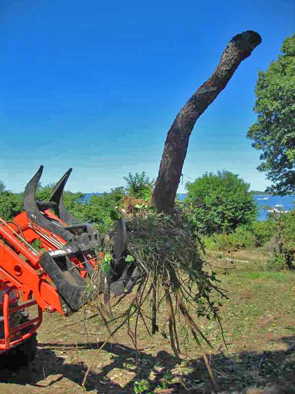

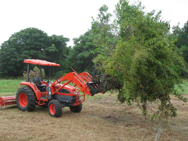

You don't mention any FEL hydraulics to control a root grapple. Do you have a diverter or are you intending to use rear hydraulics? Rear hydraulics work fine but for the kind of dough you are investing you might as well add either a diverter valve or electrohydraulic valve so you can efficiently control a grapple. WR Long is a good source for both and Nelson Long will tell you what you need for your tractor.
On the subject of grapples, I do the same work you are planning and use the grapple 95% of the time (bucket 5%). I don't know the power of your loader compared to mine. Mine has a lift capacity of 2700lbs at pivot pins. I use a 48" Millonzi grapple and think it is great. I've had it for about 100hours of intense grapple work and it works great. Cost is about $850 plus shipping. Don't get talked into buying a heavy duty grapple. Waste of money and cuts your lift capacity.
