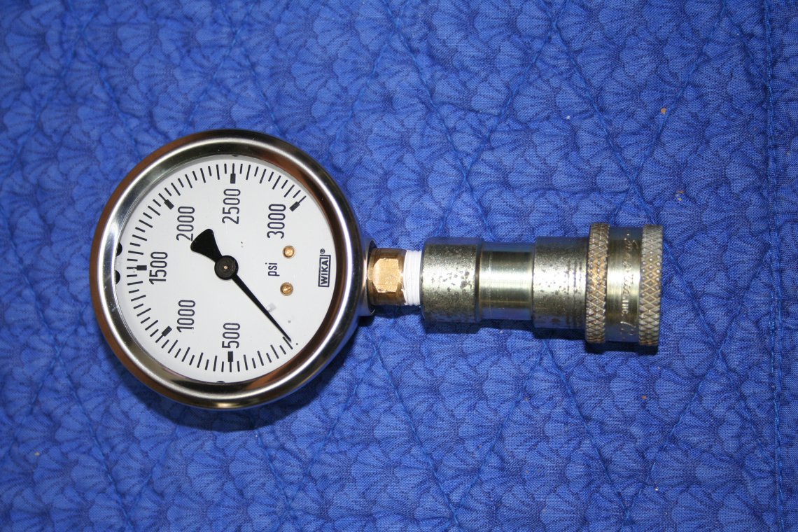

Where in the heck do you get an affordable gauge? Most of the kits are thousands of dollars and the cheapest was almost $400. Not getting why these kits are that expensive. For the price, JD can make a service call. :)

   / JD4700 hydraulics are jerky/shuddering #5

Thanks of the link and photos. I saw gauges at Northern for at most $20. The kits I was seeing online had a few gauges and some connectors. Connectors can be expensive but not that expensive. :laughing:
I was wondering if I could just get the gauge and a section of hose. Just like you two suggested. :D
