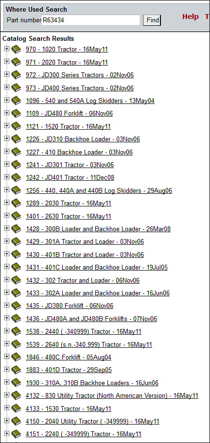

First post, so Hi all. I have a 1969 diesel 2020 that the Hi/Lo is shot, in fact it grande'd which ruined the clutch housing. When looking for parts it seems that JD has stopped making them and the re-manufactured ones are going for over $3k making that a tough option. So I had a thought, is it a good one?
Since the Hi/Lo is a fairly common issue and since JD also made the 2020 without it, I was thinking I could find a doner tractor with a bad motor and simply split both at the clutch housing and re-connect. However, finding a 2020 in this condition has not been fruitful.
According to the parts manual, the same clutch housing was used 17 different tractors in addition to the 2020; 300, 301, 301A, 302, 400, 401, 401B, 820, 830, 1020, 1520, 1530, 2030, 2040, 2240, 2440 and 2640.
So does anyone know what issues I might have by using one of the 17 other tractors? Maybe one of them will make the swap easier? Maybe there are other tractors that will simply bolt together? Other options?

My WAG is flywheel housing on 2020 engine will fit a whole lot more clutch housings than 17 models. My research revealed 31 models that the clutch housing would bolt to 2020 flywheel housing. I've never seen a JD utility tractor hyd hi-lo explode. & I think 155-165 psi hyd pressure will not explode much. Did someone tow this 2020 with trans in a gear?
HTH's,Jim

Thanks for all the input, the part# (R634334) mentioned above to search for compatible tractors is the flywheel housing, I was using the clutch housing and from the looks of we were using the same parts search engine.

If I were looking for a donor tractor, I would search for tractors that used the same Hi Lo assembly. Some of the models that share the same clutch housing have different clutch splines and pilot bearing sizes. AR82016 is the HiLo assembly. 1020, 1520, 1530, 2020, 2030, 2240, as well as some models made for countries other than USA all use the same HiLo and should be direct bolt on fit.
/ JD2020 Hi/Lo shot #10
jd110
If one installed """new pilot brg & clutch plate to match donor clutch housing""" wouldn't that solve the parts mismatched problems?
