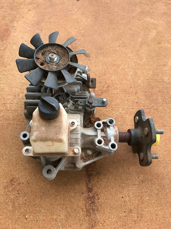

I have a Z525E. There are 2 deck sizes, the narrower seems to be sold by JD, the wider by Lowes or HD. There is no transaxle. Each wheel is driven by an independent hydraulic pump and motor. The attached picture is of the right hand drive. There are 3 versions of this drive unit and the 1st 2 seem to fail fairly quickly (as in less than 50 hours). The OP's write up is very similar to my experience except I've not had the fuel problem. The drives are actually pretty easy to drop out and replace with a new one. They are expensive though, $900 actually isn't to bad, my left hand drive was $1300. I've not been able to find a repair kit for them.
I have a JD tractor and JD attachments. Trying to buy the Z from them (even though they carry them) was so difficult I gave up and went to Lowe's to get one. I suspect the OP bought one from Lowes or HD as well and had one of the earlier drive versions. Unfortunately, he will probably have to replace his other drive in the near future. I have ~55 hours on my machine and a little over 3 years which is beyond the 2.5 year warranty period.
Correction: JD calls it a transaxle. But, I've not been successful in obtaining parts for them. JD will sell the assembly but not the individual parts. But even then, by the time you buy the parts you've spent enough to buy the entire drive.
Well someone makes this, and unless JD make it themselves, maybe you could buy parts from the drive manufacturer.
