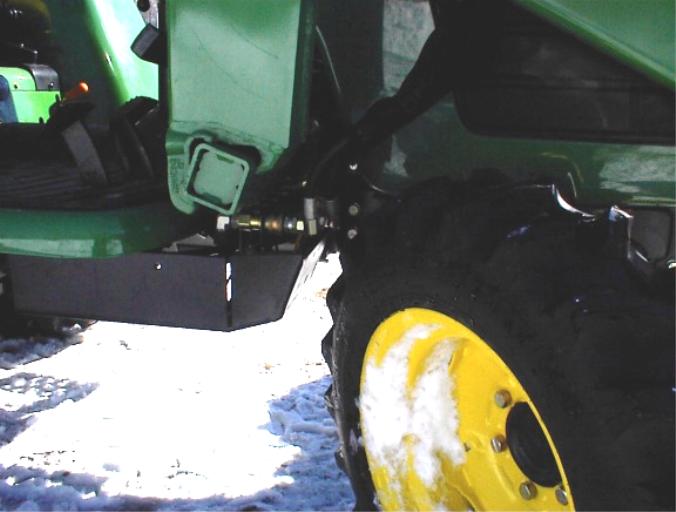

RCH, last fall i got the "JD Xtra Armor Kit" for my 4400. The dealer tried charging me extra for the cutting edge for the bucket, and the guard for the mid-point hydralics which you see are included in Mikes attachment. WARNING! Mid-point hydralics guard DOES NOT work if you install the 6-ply 7-16" r-1 front tires! After coming out to install the guard, i started up my tractor and pulled out of the barn and made a right turn........ only to have the front end jump then dive scaring me half to death! i immediatly shut down the tractor and did a "walk around" and found the front right wheel had drove itself under the guard with the weight of the tractor on top! If i had turned the wheel to the right further than i had i would have torn the tire of the rim or even the entire wheel off the tractor! Called the dealer and they sent out their sv mngr who pulled off the guard three times to rebuild so it would fit proper! As for the kit in general, i like it although a skid-plate covering the entire bottom of the tractor would be nice........i spent the first 8 hrs running an MX-5 rotary cutter, brushing NEW trail thru the woods and running over trees as thick as my wrist the guards seem to be doing their job.................. mark

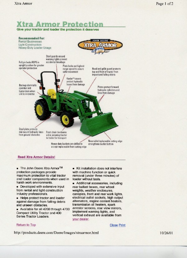

Hey Ray, sorry i didn't get back sooner. The cost for the entire kit was $615.00. Everything that was included was in the down-load i got off of the JD websight. The dealer didn't want to include everything you see.( he tried charging me cutting edge for bucket, warning light brush guards, and tried to tell me that the mid point hyd. guard was not included.....also extra) He didn't appreciate me confronting him with the print out from JD. Seems his dealers book had differant info. As for the skid plate, thats something one would have to mfgr one self. I haven't really looked to closely at it yet. The only way to keep away from the 6-ply tire/mid-point guard conflict is to either not get the tires or not get the guard... or...do what we had to do, and that means remanufacturing the guard so there is no conflict.... 4300 would have the same concerns because the only real differance with the 4400 and 4300 is a couple of hp. will try to send some pics.......... hope this helps.................mark

..............Mid point hyd guard, had to be shortened approx. 4"........

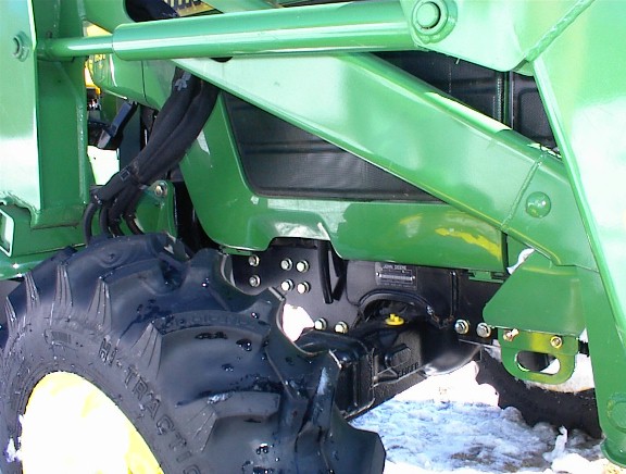

....tie down attachments and kevlar covers...........

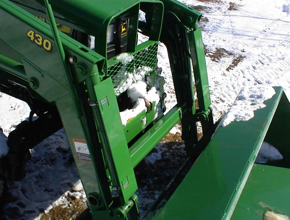

..............protective plates for hyd cylinders....................

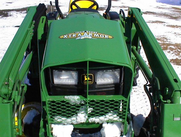

..........hood and grill guard...........
