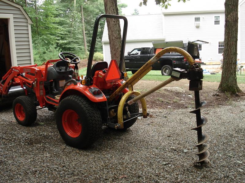

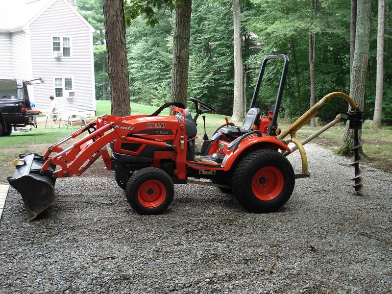

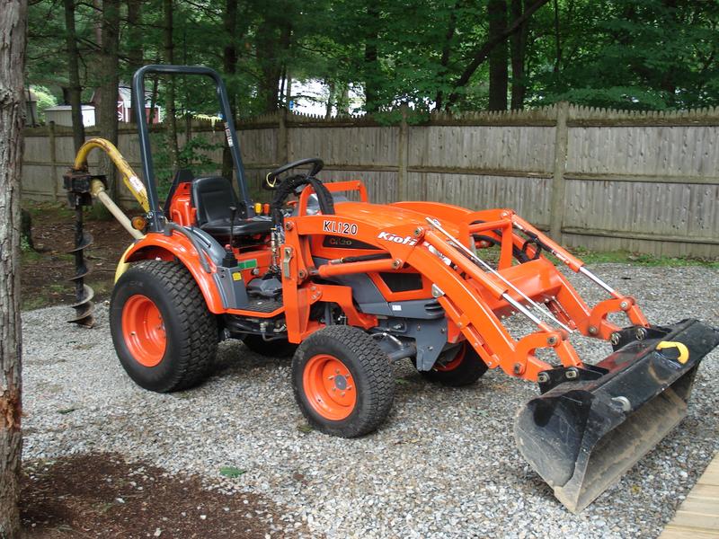

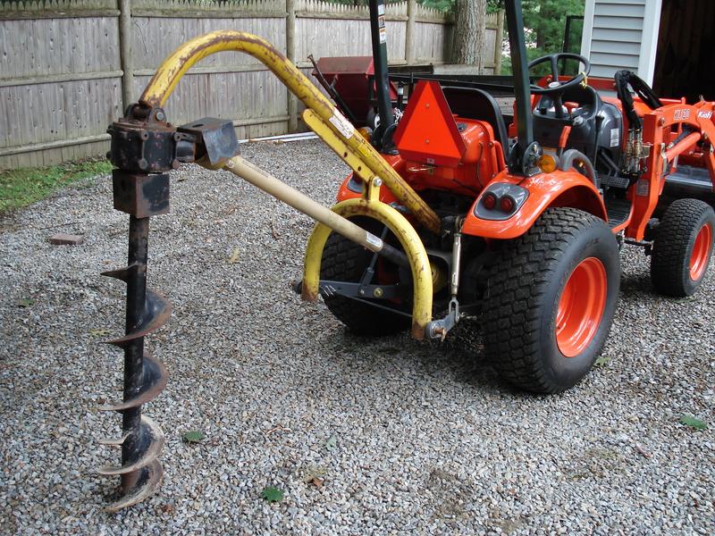

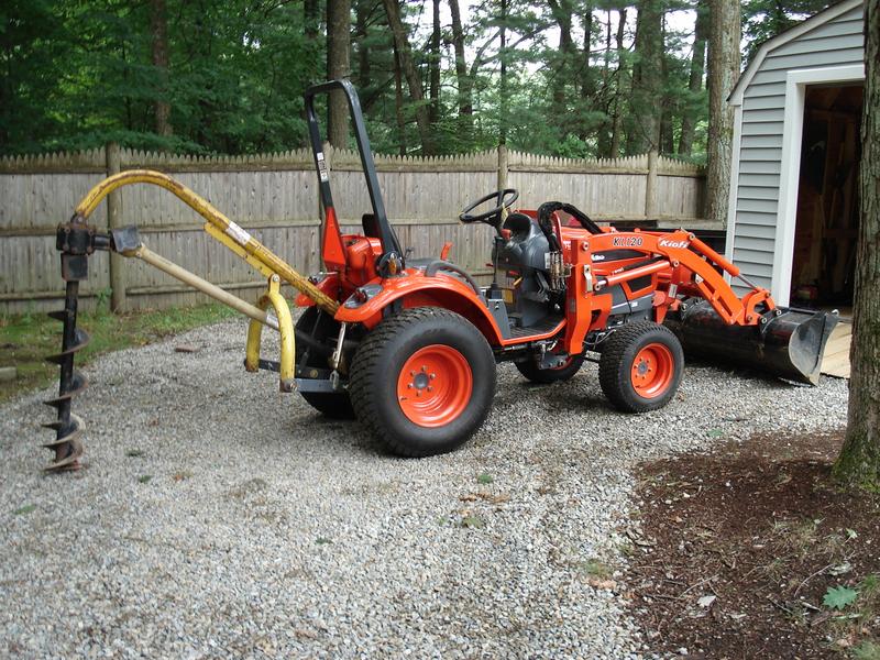

Turns out a guy I work with who has an older 22hp JD machine owns a Greenline EM5000 PHD that I have borrowed and thus didn't need to rent one. It can be seen here:
I'm all setup w/ extra sheer bolts, 9" auger, and beefy pipe wrench and we should be digging some holes pretty soon. Here's some pictures of everything ready to go. Went on nicely.

Today went great -- 5 out of 6 holes we were able to auger right on down to the lowest the 3 point would go. One hole has a massive rock we plan to jackhammer tomorrow. Only sheered one sheer bolt due to a small rock in the first hole. Did everything at idle. Used Bearhawk's tip of digging a starter hole by hand to keep the auger where we wanted it centered.
The only thing that could have been better would be a 12" instead of 9" auger since code requires 12" sonetubes for deck footings here. An auger extension might have been nice also since we needed to go down 4 feet.
But I can't complain -- the PHD save a lot of time and labor today.
