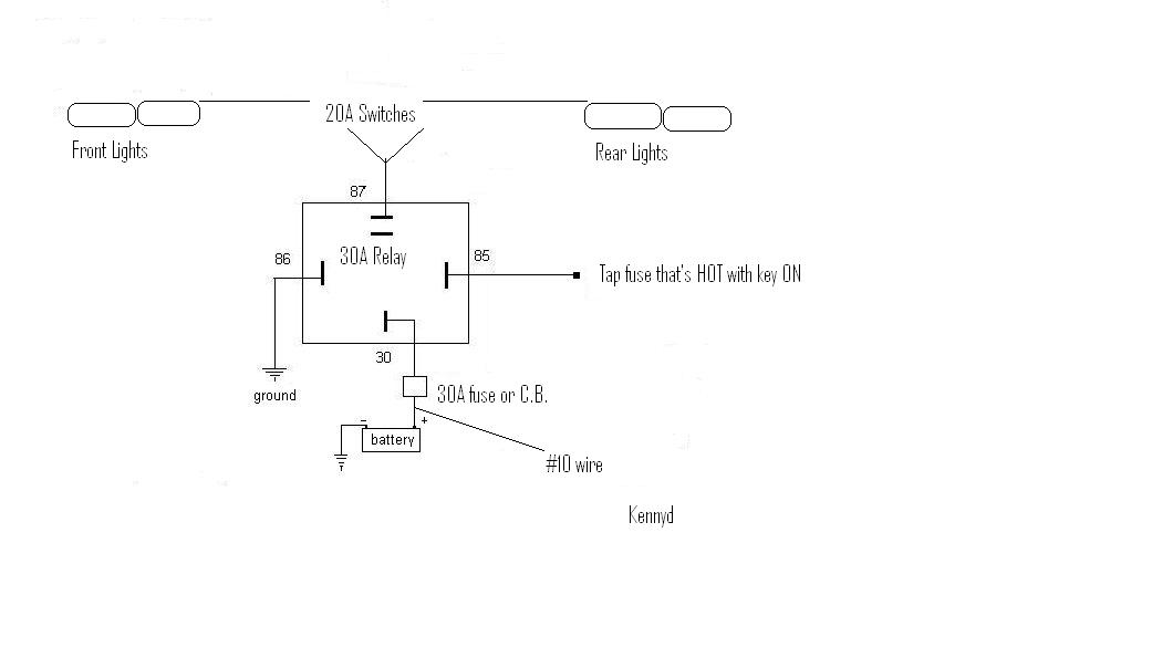

I'm looking for the electrical "clips" that hold the fuse in the fuse box.
The fuse box on my 2005 JD 3320 has several open circuits. I want to use one of them to power some add-on work lights, and I want to use a separate switch from the dashboard light switch. Problem is, only one half of the little clips are in the open fuse spot.
I've searched the JD online parts and have not been able to find the part I'm looking for.
Anyone have an idea??
Thanks,
-John
   / JD Parts Question #2
You will probably never find them short of ordering a whole new fuse panel.
The best way to add a new circuit is to use a relay from the battery, triggered by something that is HOT only when the key on ON.
Here is the way I did mine:

I pulled the fuse panel out to see what I have to work with. There is one pretty good sized red wire (10 or 12 gauge) that is "hot" all the time, which is what I would prefer to use.
Unfortunately, the tractor is up North (300 miles away) and I'm not going to be back there for a couple of weeks, so I can't take/ post any pics.
I was hoping to be able to find the clip so I could just use a standard size fuse and make it look like a "factory option"...
