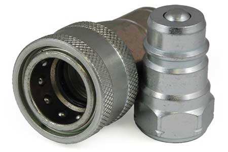

I read an article about mismatch with poppet and ball type QD's a while back. If you are using QD's, check and see if both the male and female QD have the same center, such as a ball to ball, or a poppet to poppet. Try to avoid poppet to ball. One of those has better flow characteristics. I think the poppet is the better one out of the two.

/ JD Log Splitter SAGA Continues !!!
J_J,
The QC are AG ball type. The same that I use on all my equipment.
This problem really has me stumped. It's 14 degrees and I'm running out of firewood
