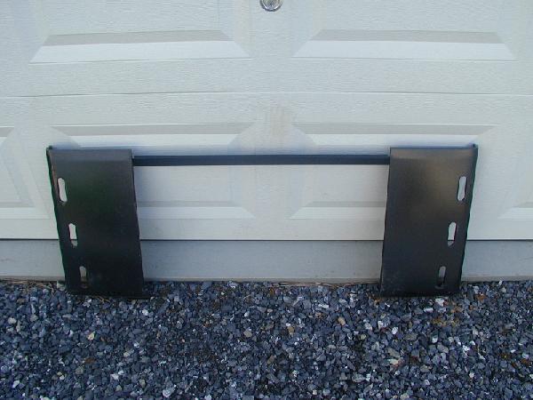

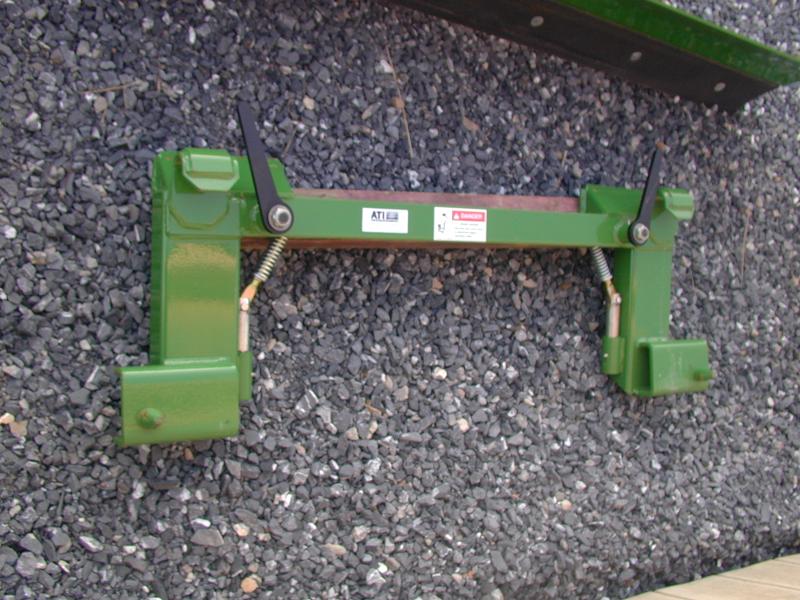

Here is the converter plate I used to mount Skid Steer attachments to my JD - About $500 - Made by ATI. So far I have a Fork lift from King Kutter - A blank plate is available from Bobcat for about $75 - With the plate you can mount anything you can come up with. /forums/images/graemlins/cool.gif

Bobcat Blank Plate

Easy as opening a computer case - Drop your JD loader bucket - hang the ATI converter on the loader arms and lock in with the lynch pins (same one's used on the bucket). Go pick up your Skid steer attachment and lift off the ground - Push down on the two lever handles you in see in the ATI attachment above - (line up the holes please!!!) - be on your way. /forums/images/graemlins/cool.gif

The drawback to this system is:
another set of connections between your loader and the skid steer attachment
Weight of ATI attachment piece
Your skid steer attachment is about 3 inches out further from the front of tractor
Available for most brands of tractors - I bought mine thru local Bobcat - shop around for price.
