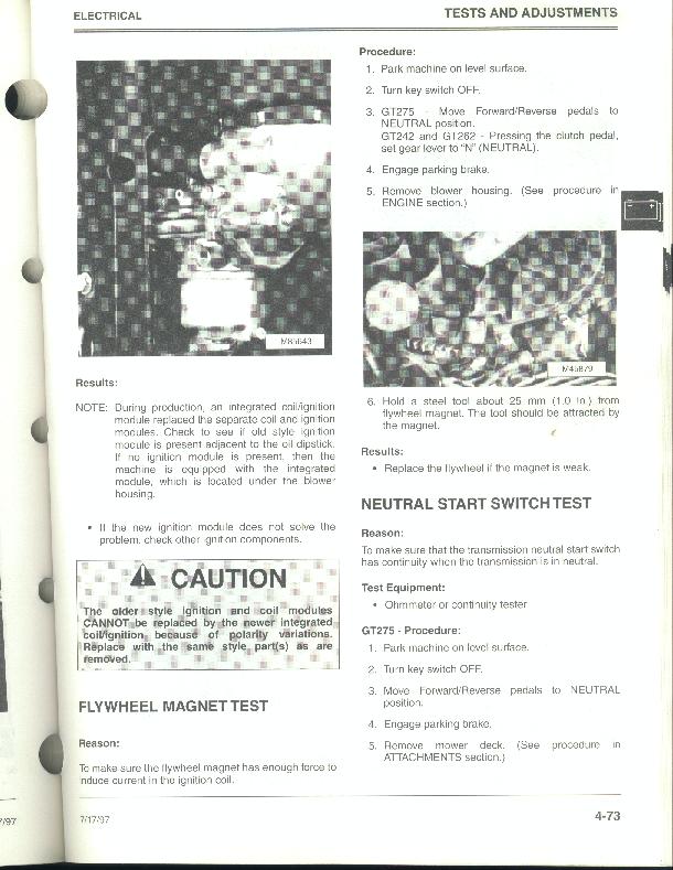

You might want to check the ignition Relay(K1) , Battery for the ignition module and coil break through this as well.
There's more if You want it! /forums/images/graemlins/grin.gif /forums/images/graemlins/grin.gif

I think they had a part called an ignitor.... might be that....
although I think they usually start acting up with some intermittent problems before it totally quits.. it's a small metal looking flat squared piece on the side of the motor,, i just can't tell you how to test to verify for sure if that's whats bad..
good luck

Did you find the problem? I have a gt 275 and the pto switch quit and I jumped part of the switch and after shutting it off to eat lunch, It will not fire or spark at the plug. If you found what the problem was on you tractor please post. Thankf putt0pup
