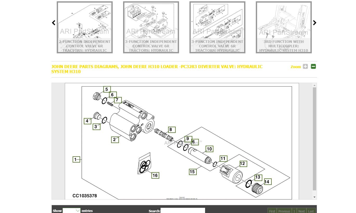

I have a hydraulic leak in the main structural cross/connecting tube and upon opening the covers, there is an extremely poorly designed (IMO) morass of tubing and I believe a diverter valve, etc. "I do have a 3rd function integrated into the bucket, but it has its own set of E/H valves on the tractor." I have no idea what it is 'diverting' unless it is just to insure both cylinders are getting equal flow to keep the lift even.

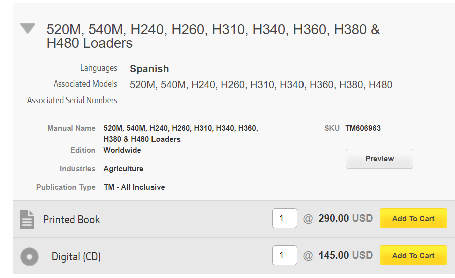

They have OEM Technical manual available on the loader, but it is $260. By then, They are more than half way through fixing it, and THAT SPECIFIC issue is the only thing which isn't straight forward. Its not like purchasing the TRACTOR tech manual, where it is likely to be used many times. This is $260 for a FEL tech manual. So, if any of you have any lines on getting one ONLINE at a more reasonable rate, I'd appreciate it. Otherwise, I'm likely just going to take my tractor back to the shop Monday evening and leave it for the week again.
The 3rd function is dealer installed. All main hydraulics are WITHIN the main tube. It is a mess. The issue is, that there is no access to either side worth a ****. It appears that I have to disconned EVERYTHING from both sides in order to remove ANYTHING. The RIGHT side hydraulic connections are held on by retaining clips.
This is a long video (6min) showing what I am up against. I've not run into anything quite like these retaining clips on hydraulics. I wonder whether, after removal, there is a quick connect which can be pulled back, releasing the connection?
