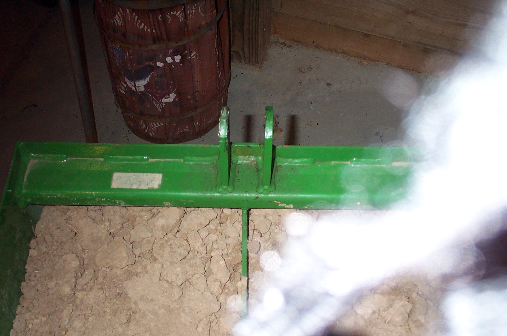

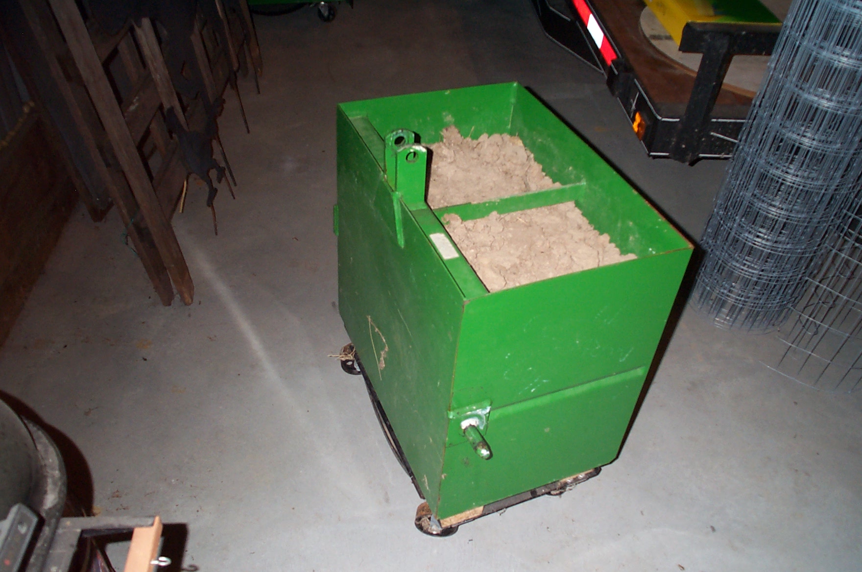

Yes, I have some pictures of the ballast box. Here they are.
Is this the older unit? If it is, how do I modify it to work?
(still makes me mad that JD dealers were selling ones that weren't i-Match compatible... :mad: )
-Bob

   / JD Ballast Boxes - i-Match compatible? #9
Definately looks like the old model all right. Do you have a welder and sawzall? Measure the distance from the top link pin to the side arm pins. Let us know that that is. May be a simple mod of cutting the box below the top link pin enough to get the hook in. You will still need the bushing kit forr JD or from F&F or TSC. Check out the pick in my reply above for pictures of how the newer one works.
