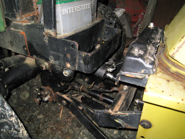

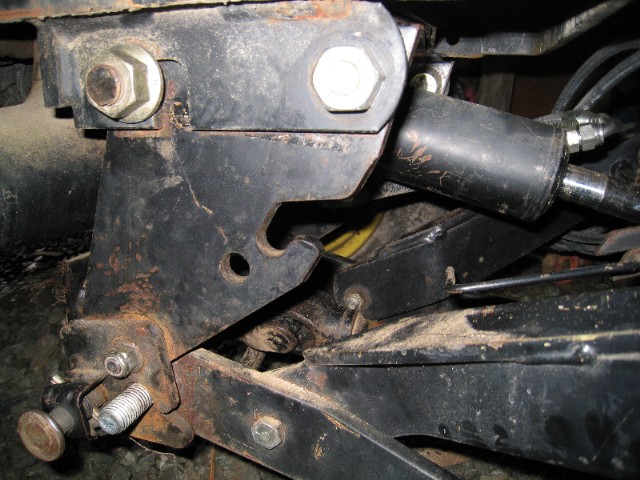

I have a JD 59" snowblower, recently purchased used, for my JD 955 tractor. I was told it was off of a JD 955 and so it came with the proper mounting brackets. It seems to hook up fine, but it won't raise up off the ground more than one inch. There's not enough "stroke" left in the piston.
It seems like the tractor sits too low, maybe due to the worn turf tires? Wrong bracket?
Pics attached, note the small amount of stroke left in the piston when sitting level.
--Doug

Have the attaching mount changed by a welder to get more stroke. Double check the mounts too. Doesn't maybe go in the upper 'hooks' shown?
Is the length of the PTO shaft okay?

It's difficult to see what could be modified in isolation to make a difference, without causing some other problem. The clearances are very tight.

Right. It doesn't change the geometry of the piston. The problem is the mounting bracket on the tractor. I need to make a cut above the pivot point of the arms, and below the attachment point of the cylinder. Shift pivot point forward two inches or so and weld it back together.

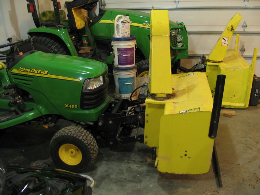

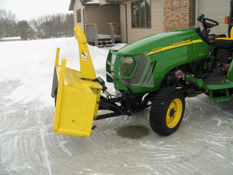

Your arms are in the wrong set of holes where they attach to the blower itself.
My 59 came from a 855 with turf tires and used these holes. Also check the bolts used for connecting the mount to the frame. When they get worn the whole mount rocks rearward/down and you lose lift. There was not much lift from the factory to start with. I made my own frame mount for my 3720 so could have more lift, not have to remove the grille guard, and not have to remove my mmm mounts.
The extra holes on the blower are for other models. I have the 55 series manual for it but it doesn't show setting it up

This pic is with the blower all the way up and worn bolts if I recall. Not helping are the low front tires but your 955 should have a larger size. It is kind of wimpy compared to the 318-430 lift height.
On my last post, the first pic was a random 4400 that I had.
Tim

You are right on all points. Moving the front arms to the lower bolt holes would give me a bit, and the bolts I'm using for the front bracket mount are 1/8" undersized making it rock back a bit, (and my turf tires are very worn).
But even if I fixed those problems, and got new tires I don't see gaining more than an inch of lift which wouldn't be enough.
I'm working on modifying the bracket to move the pivot point forward about an inch and a half, which should give me twice that in lift.

Moving the pivot point forward fixed the low rider problem, the blower raises up 12-16" now. I cut the bracket just below the cross piece, moved the pieces 1.5" forward, and welded them back on.
