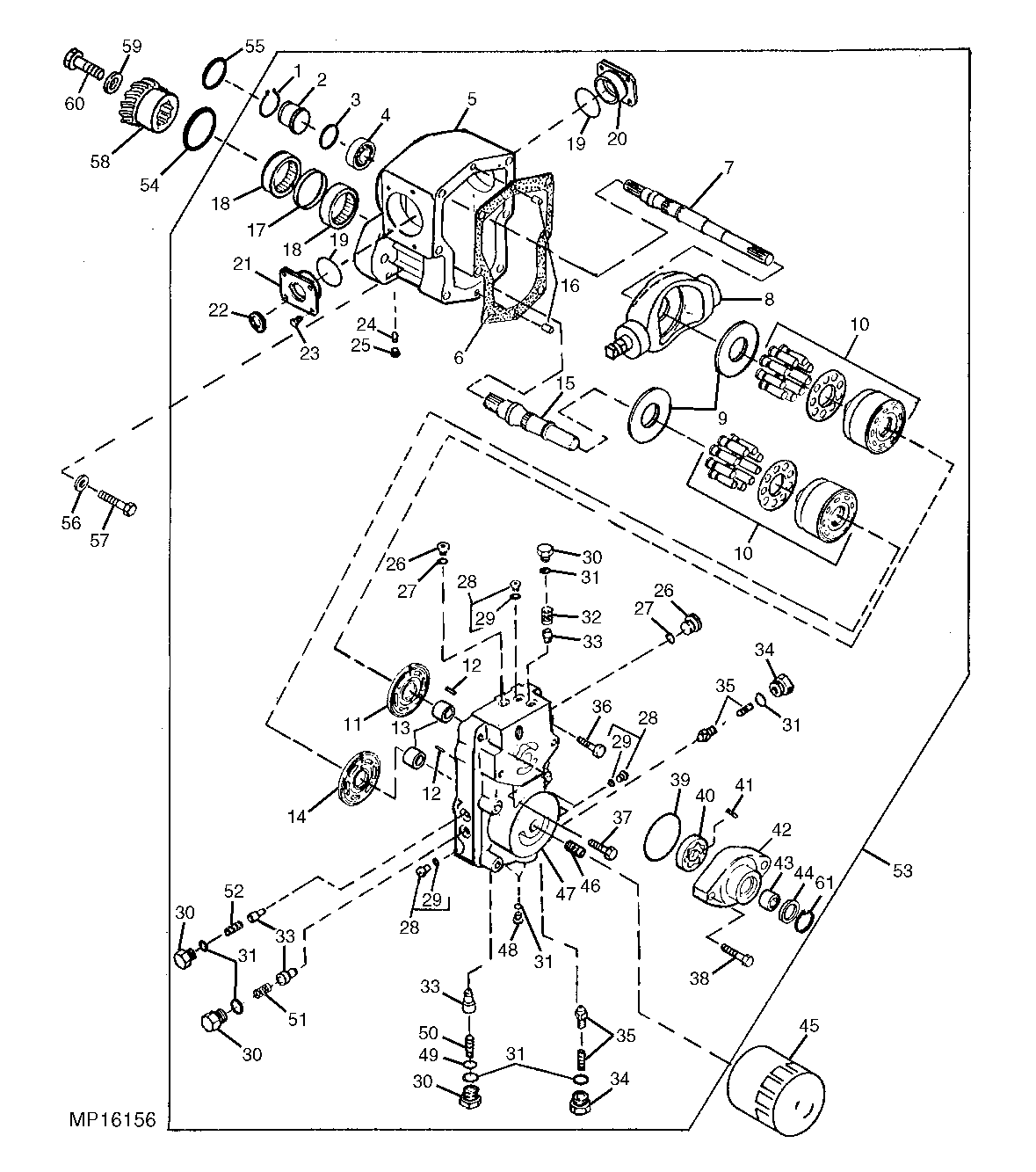

Sulley, where to start ahh yes all implements work no other leaks and when i strained the oil found more brass than I ever wanted to see so looks like i will be tearing the trans down. I have heard of a failure to do with the bolt that holds the reverse bevel gear on to where when under a load it can shear the head off and then because of design in the forward direction the geartrain will suck the gear back in but when rev is engaged it will spit it out to far not entirely sure and not to sure on where to start just yet. I am hoping that someone might have an idea on where this part of the gear set is to avoid a complete removal..... bumming right now need this tractor up but i dont want to do any more damage trying to run it with something wrong in the geartrain thanks for the reply and ill keep you all posted

Thanks Joe..... you have any idea about this bolt holding on the reverse gear im looking at the drawings and its not standing out like i thought it would
   / JD 955 reverse not engaging #9
Could it be bolt (key 60) holding gear(key 58)?
