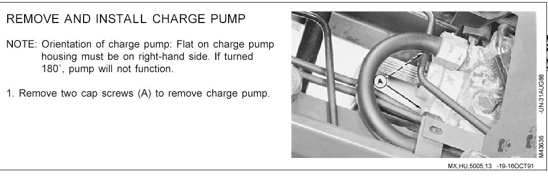

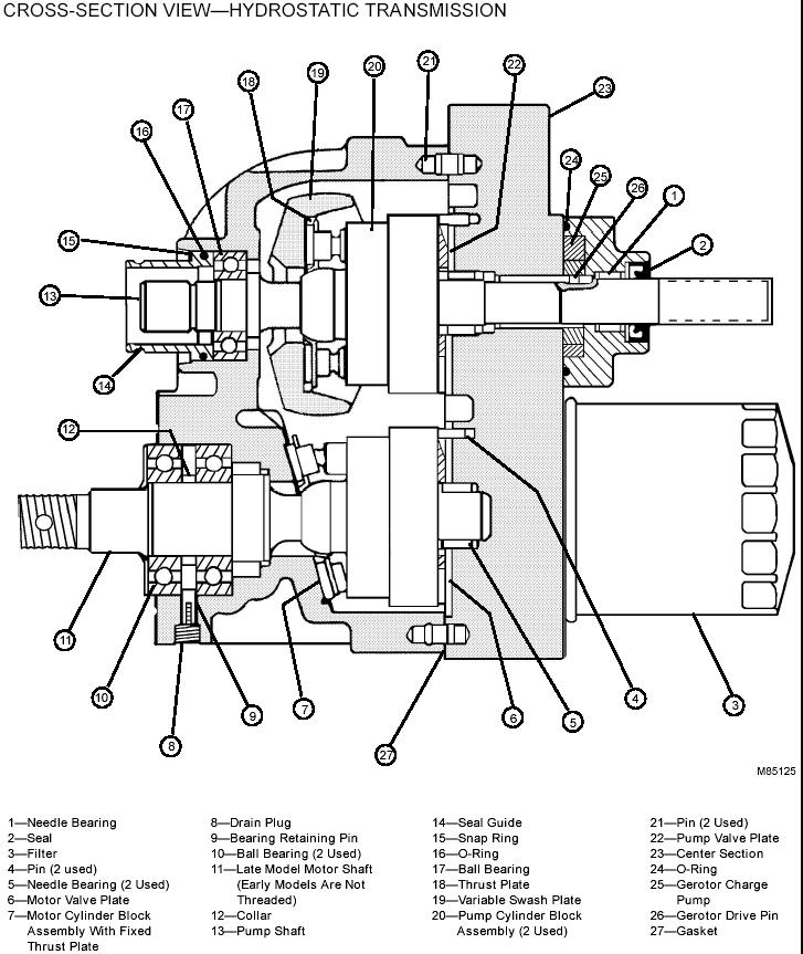

Just passing these figs along for what they might be worth to you. First is cross section of tranny, showing the through shaft with charge pump on right and where hyd. pump attaches on left.
The second is removal note on charge pump housing, and precaution to not put it back on wrong.

I hope it is just a pin... but I don't see how shearing that pin would knock out the implement pump. I've attached a couple pages from the manual to help explain my thoughts.
View attachment hydro_trans.pdf View attachment transaxle.pdf
Look at the trans diagram. That shaft is a one piece shaft, splined on both ends. Now look at the transaxle diagram. The mainshaft through the transaxle has a splined coupler on each end. If you lost both trans and implement pump, you would have had to shear the gerotor pin in the trans charge pump AND wiped out the splines on one or the other of the shaft couplers. I think it would be more likely that a shaft broke than the splines stripping out of the couplers.
I'm just guessing, but a single shaft break in the cloud on the trans diagram would keep from transmitting power to the trans charge pump, the trans pump and implement pump.
I hope I'm wrong. Please post back and let us know what you find out.
