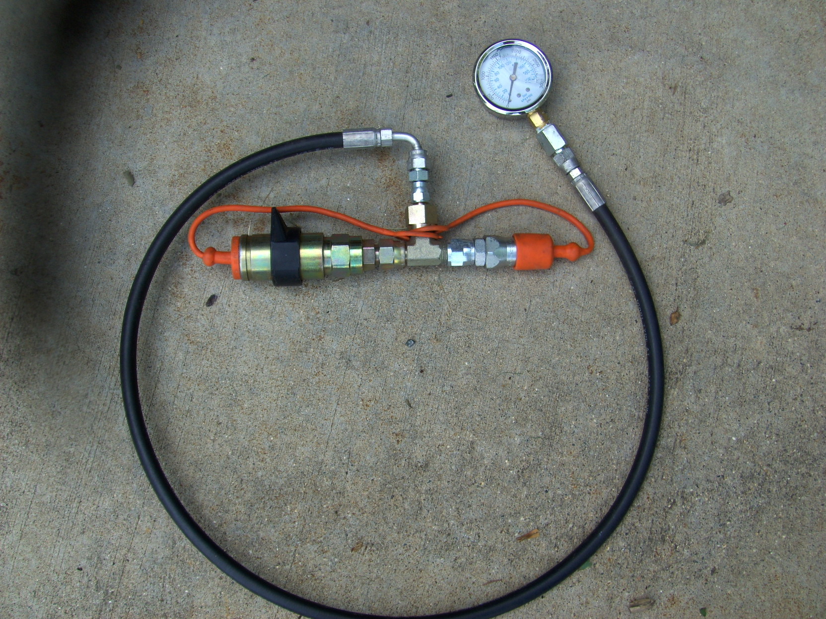

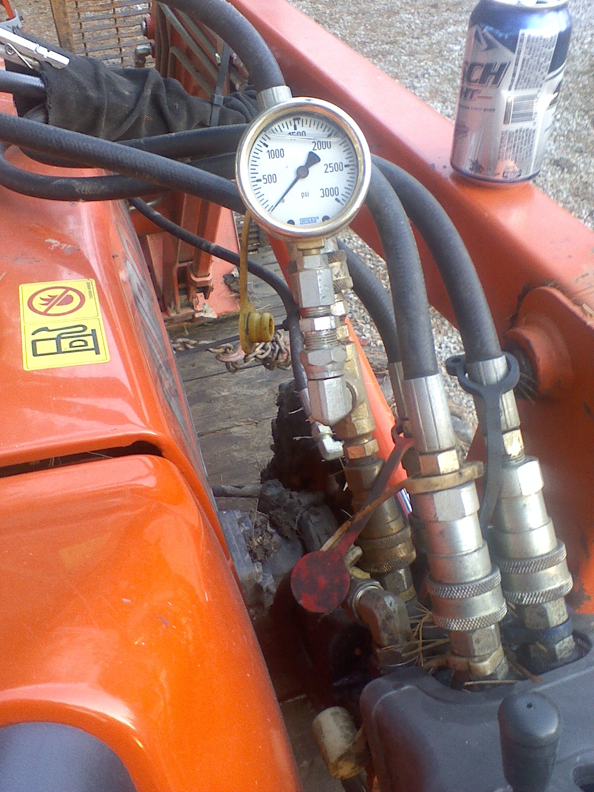

It would depend on the gauge size, and the QD or the tee fitting.
You can make a portable tested or install the gauge in a tee in the IN port of the loader valve . This way, you can check out anything hyd on the tractor.
The QD plug in only checks what you plug into.
Your loader drift down could be caused by cyl seals or worn spool valve.
