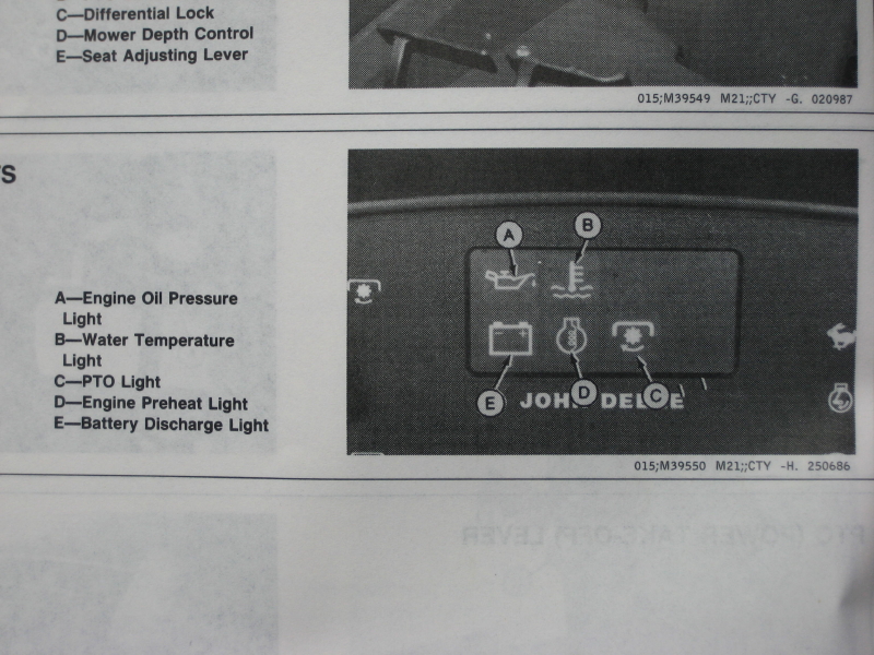

Hello,
Noobie here. I just got a John Deere 855 4wd with a Front End Loader. Got it for the "Deal of the century". I plan on picking up a rear blade, harrow and brushhog later this month. My intended uses are keeping the brush at bay, landscaping and moving snow.
The problem is, I don't know much about Tractors, I have no owners manual and the lens covering my dashboard idiot lights is missing.
Question: Anyone with an 855 know what each of the dashboard lights do/mean? There are bulbs in 5? of the slots but I have no idea what they mean as the plastic lens covering them is missing?
Any deals on owners manuals around?

madpogue said:
I'm thinking: Top row, oil pressure & coolant temp. Bottom row, alternator, pre-heat, ?????
and PTO indicator.
I used to have them all memorized because for the longest time my panel screen was missing too. They fall out fairly easily.

I have an 855, and the picture is exactly what my panel looks like. madpogue and slaveToHorses gave the same description of the lights that I would give based on my panel. Enjoy your new tractor. If you don't mind me asking...what did you pay for your 855?

Here is a picture of the appropriate page from my manual. This is the first time I've done an attachment on this program so I hope it works OK. I found my manual on Ebay. I like the tractor but then it's my first one so I may be naive

The engine preheat only works when the ambient temperature, as detected by a sensor in the engine compartment, is cool. During the summer you should never see the light. When the temperature drops into about the 60's the light will illuminate when you turn the key on. You should wait for the light to extinguish before you crank. The light going out indicates the preheat cycle has been on long enough to attempt a start. Mine has an air heater and no glow plugs. I think most if not all 855s are that way.
I use an electric block heater when the temp gets below about 40. I only heat for about 30 minutes. It makes for much easier starting and saves on starter wear and tear.
