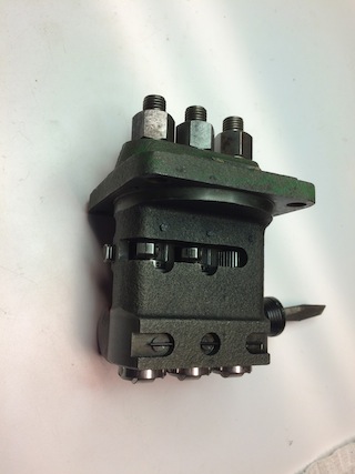

I'm working on a 1986 John Deere 850 tractor with a 3 cylinder Yanmar engine.
The owners said it wouldn't start after not running it for a number years.
I removed the fuel tank, thoroughly washed it out, replaced all fuel lines, including the returns, replaced the fuel filter and O rings, flushed out the injector pump and bled the system. After a good charge, it fired up. Ran fairly even, but the acceleration and idle were erratic.
I noticed the throttle lever had been damaged and modified (cowboy tractor). So I removed the Governor inspection plate, Injector Pump and side plate. The Pump was a bit gummed up, the governor spring was chewed up from the cam gear and the governor link and lever adjustment were swinging in the wind.
Prior to reading that this pump has the makings of a Swiss watch, I disassembled it, washed it and reassembled it (using my best judgement and the increments and markings on the different parts). Bought a new spring and set up the governor as per some instructions I found posted here on TractorByNet (thanks).
It seems to run a bit better, but not as smooth idling as I would think, and it feels like it's pulling too hard under load. I suspect the adjustments of the Injector Pump is still off some what. I've searched for just some tech information, but it's like finding the Holy Grail.
Does anyone know where I can find some information on the Injector Pump rebuild settings? I could just keep pulling it and resetting and maybe get it right, but I'm afraid I going to wear out the nuts and bolts after too many tries.

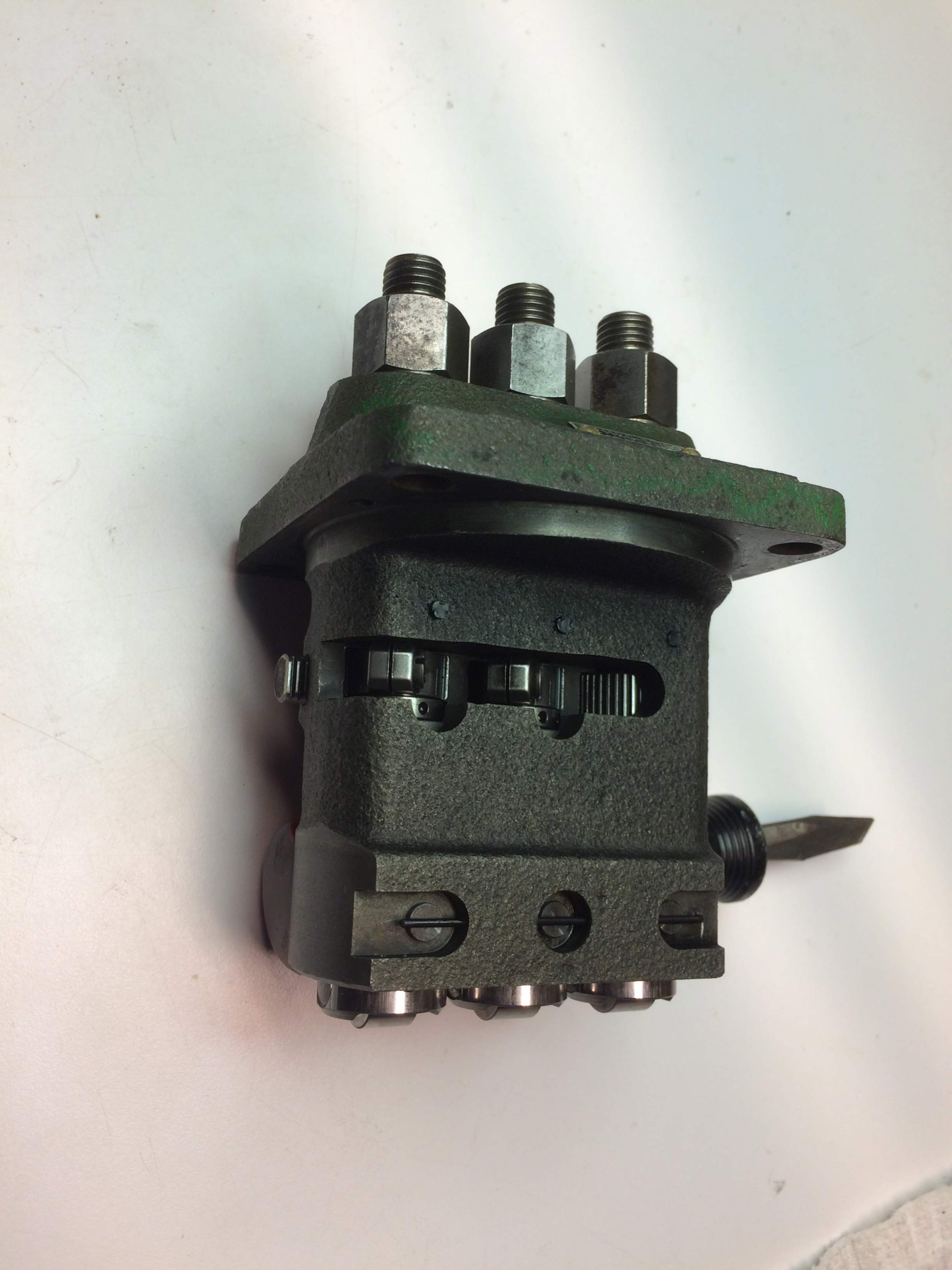

#9
The fuel supply from the tank to the Injector Pump is gravity fed, there is no electric fuel pump booster.
(the image is of the Injector Pump on the JD850)

Today I found it is possible to successfully rebuild this Injection Pump, even without the highly guarded instructions and specifications.
With close inspection of each part considered and the purpose of its function in relation to related parts, I was able to set it up as it was originally designed.
Along with properly setting the timing, adjusting the linkage with the governor, the results were a smooth idle, responsive acceleration and maximum output under load. For a 30 year old tractor, its performance is amazing.
We are now pressure washing it, lubing everything and taking it up to Reno, NV this week to trade in on that JD110 the owner wanted.
So, if you are considering rebuilding your own Injector Pump and you have a little time on your hands and don't care to pay the $2K the dealer requires, it can be done. Take note of all settings, take pictures of original. Lay everything out and keep it clean.
