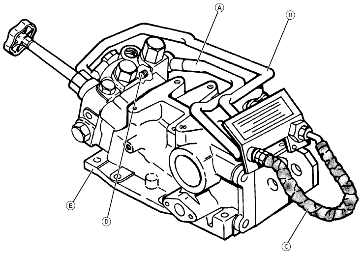

I volunteer at a state park that has a JD790. We're attempting to install a BM18046 Power Beyond Kit on it. The instructions are wonderfully vague on where and how to attach it into the Hydraulic system on the tractor. Has anyone had experience on installing this kit ? Any Pictures ?

/ JD 790 Power Beyond Kit #9
Stole these from my tech manual. Maybe they'll help.

Thanks Willl,
Your pictures cleared things up in a hurry. The issue appears to be the local JD Dealer sold us the incorrect kit. Would you happen to know the part number that you used ? The kit we were sold is BM18040. In my fumbling around I managed to find a couple more part numbers, BM18005 and BM18010 come up on the radar but I'm at a loss as to which one is correct.

/ JD 790 Power Beyond Kit #16
Here's those pics from JD parts I was trying to post.
What you have and what you want. Correct ?

/ JD 790 Power Beyond Kit #18
BM18046 is NOT power beyond. It is another set of couplers for a rear mouned implment that does NOT have it's own valve. It allows connection at the rear of the tractor (you must disconnect any thing connected to the mid couplers) (the loader function these lines tie into) Consider it a T for both lines from one SCV. One branch of the T goes to the midmount coupler and the other to the rear (what BM18046 adds)
BM18005 is what JDparts list for the 790 power beyond, Check and see if it's discontinued.
BM18010 is what JDparts lists for 770 thru 1070 and 890-990 power beyond.
Not sure if it would work on a 790.

#19
Thanks for the info. Using BM18046 to run hydraulics to the rear of the tractor for an attachment that has a complete set of valves, etc. makes little sense to me. I think before I'd install it we'd be better off ordering each of the individual parts in BM18005.

First, thanks to everyone for their assistance on this issue. I'd still be running in circles if it weren't for the assistance from you guys.
After a series of long conversations with the folks at the dealership, it turns out that kit BM18005 is still available. Tho expensive at $285, this is a much better solution to what I thought from the on set to be a very simple problem.
