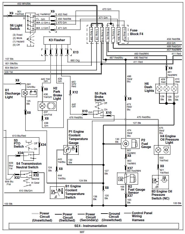

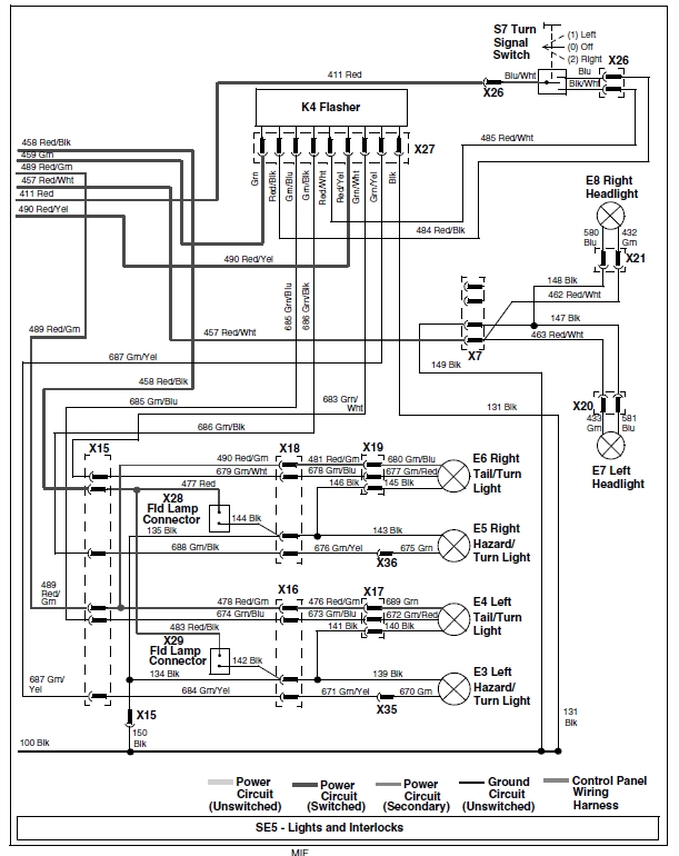

I have a john deere 790 and the battery died (dead cell). After I jumped it and got it running I noticed that I have no lights now. If i hit the hazard light button it glows red, but wont turn on the lights and flash like its supposed to. The batttery, and oil lights on the dash work, but not the background lighting on dash either. I checked the fuses and they are all good. Also, the bulbs are all good. Does anyone have any ideas or a diagram of the electrical system? I appreciate any help you can give. Thanks.

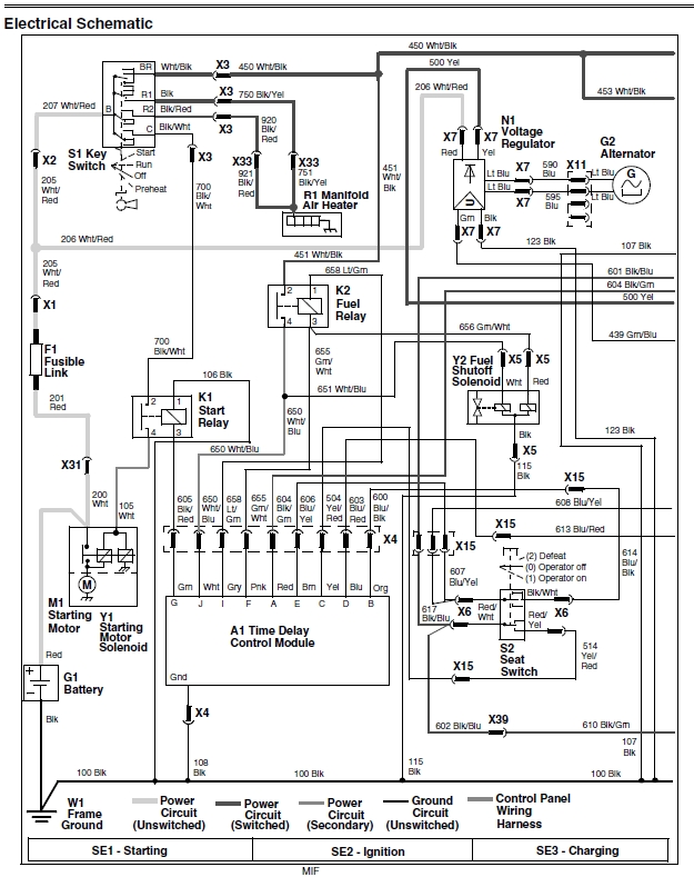

790 schematic from August 2003 manual.

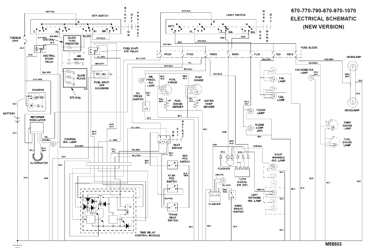

   / JD 790 no lights working!!! #3
790 schematic from March 1999 manual.
