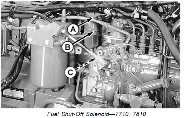

Any of you guys replace this thing before? I was looking at it last night and I can't see any way to uncouple the solenoid linkage from the pump arm without removing the pump? Surely that can't be the case right?
I can get the carriage bolts unbolted just fine but that linkage is behind the pump right against the block.
Denso pump it looks like as well.
   / JD 7810 Fuel Shutoff Solenoid #2
Your going to have to remove the filter in order to access the back side of the inj. pump & remove the clip off the sh-off lever.
The rod just pulls off.
   / JD 7810 Fuel Shutoff Solenoid #3
I just did one on a 7810 with Motorpal pump. I had to unhook high pressure lines and unbolt the pump to cock the pump enough to get clearance to unhook it.
   / JD 7810 Fuel Shutoff Solenoid #4
JD> according to the pic.. his is just a basic Bosch A pump..
That Motorpal pump is a joke.. Its Deutz's answer to the A pump.. talk about "TRYING" to reinvent the wheel.. What a piece of junk..
