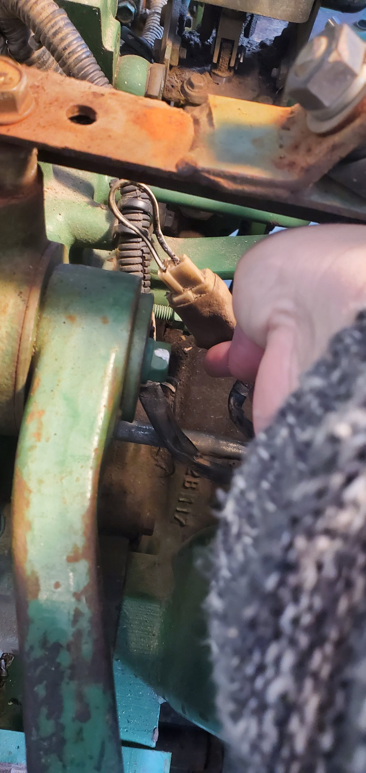

Found something was jumped.

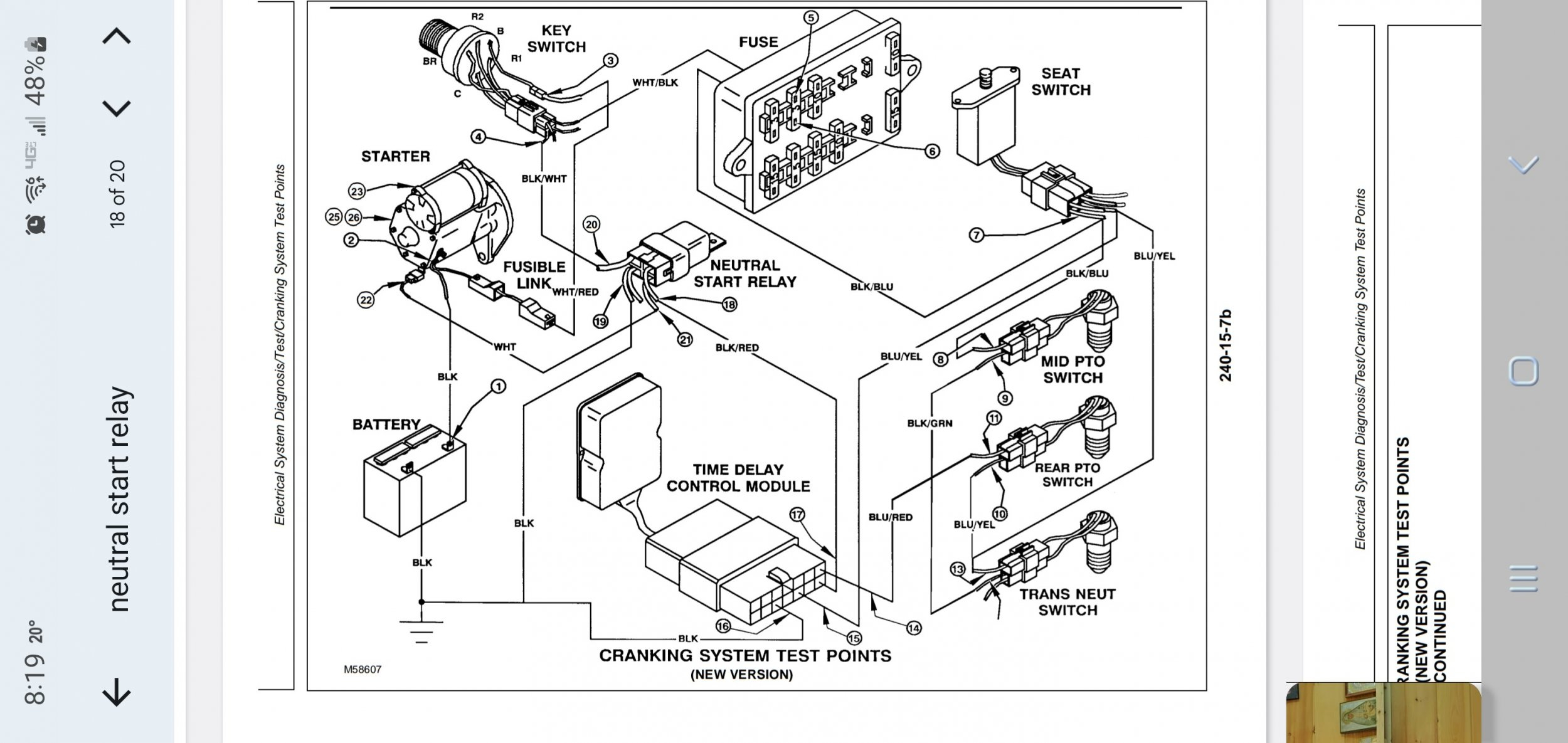

I appreciate everyone's advice and help. So far it has helped me tremendously and almost everyone is spot on in their advise. This is not something I have ever done before nor would have thought about attempting but when money is tight we learn to try and repair things on our own. I'm sure it would have taken a man afew hours to repair. That being said is the first picture for the safety switch and the picture of the bypass for the pto switch. I'm looking at the schematic but I don't think the colors are matching up. How would the tractor work without the safety switch just being cut? I have to be missing something else.

Next dilemma, I don't think I have a mid pto, there is no box with a switch. So the jumped cables I assume are for mid pto. Back to bypassing seat. Can I wire nut the wires?

Thanks for all the responses. We did get it moving. It was the seat safety switch. I did wire nut the the two reds together and black and white together to bypass and we are rolling!!! I am so happy I didn't have to buy another part.
