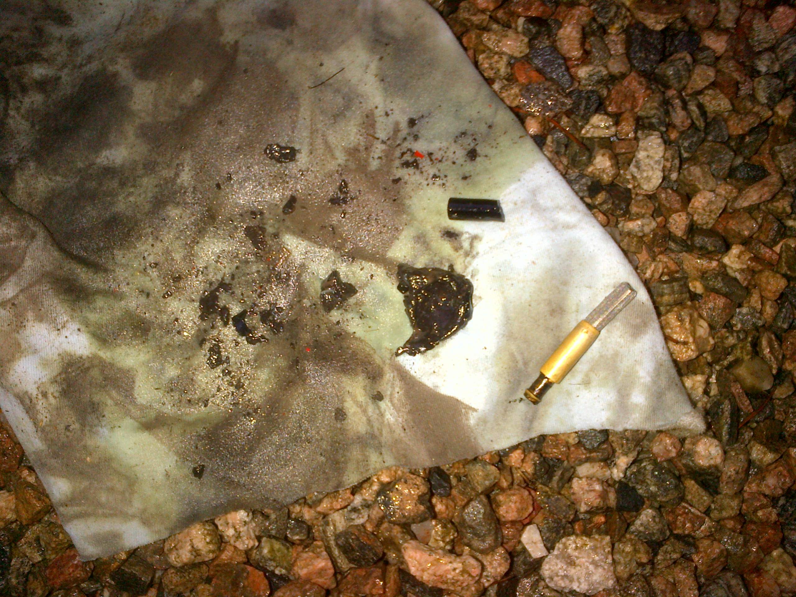

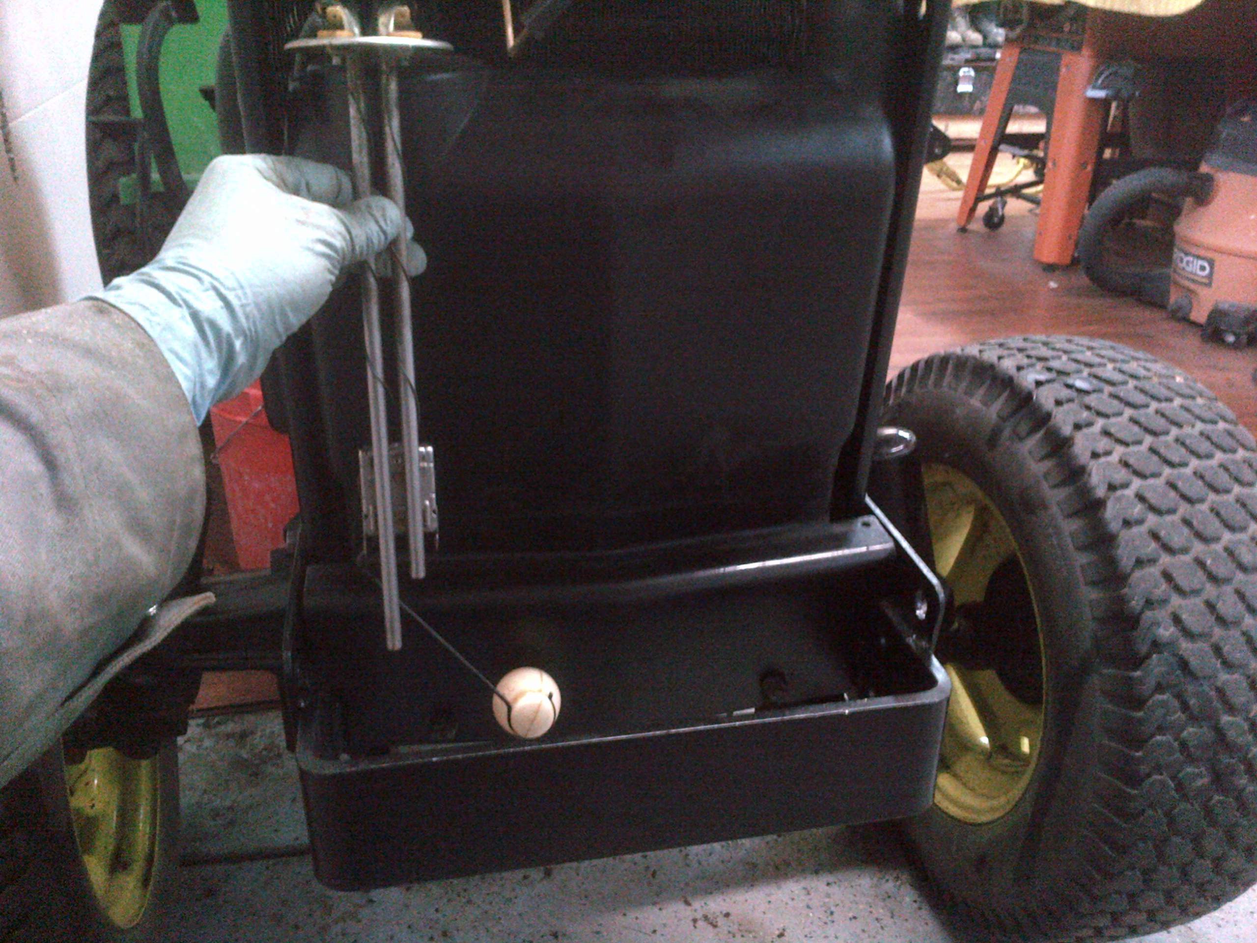

I had an issue with fuel and just like JD755's manual says, you have to remove the front radiator bracket that connects to the radiator and holds the hood. I found it easier to remove the hood, the hinges and the radiator bracket as one piece. it's just the 2 bolts on each side on the lower radiator bracket and a couple bolts along the top edge of the radiator. It was a pain for me to get the hood back on by itself and exactly where it was before removal so it fit nicely on the instrument panel. remove the 2 nuts on the lower bracket in front of the tank, the lower tank bracket simply slides up and out, and tank comes out. keep the foam on each side unless you can get some new foam to keep tank snug between frame when you re-instal. I dumped out the fuel and found the remains of pickup line and screen and i believe the metal pickup on sender was not getting the fuel at the bottom of the tank and as a result, the fuel was pretty dirty, burning poorly, and messing up filters. here's a photo of the stuff that came out of the tank and a picture of how far the metal pickup reaches into the tank without the 1/4inch rubber fuel line connected.

Second: The problem was dirt/junk in the fuel system.
1. I replaced the fuel filter.
2. Removed and cleaned out the tank.
3. Replaced fuel lines.
4. Cleaned the screen on the pick-up tube in the tank.
5. Replaced the corroded plastic piece on the end of the pick up.
6. Put it all back together, bled the air out and
7. Now it runs better than it has since I bought the tractor two years ago.
