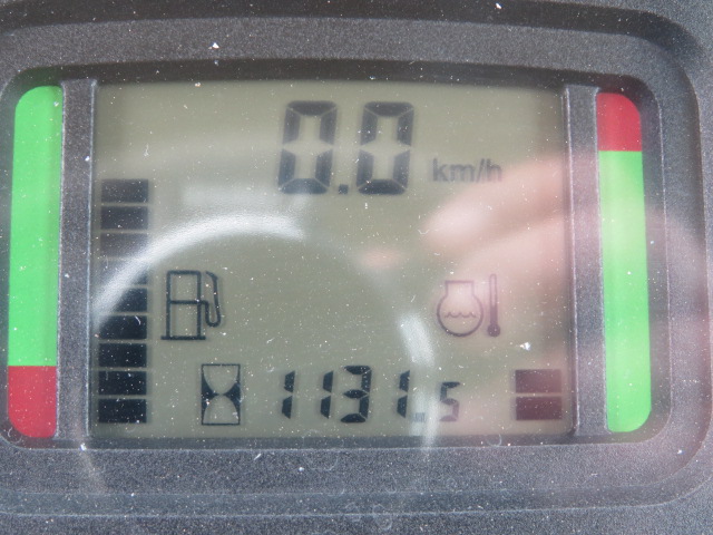

My 2008 JD 7330 speedometer reads in kilometers per hour (kph) instead of miles per hour (mph).
Can this be switched?
/ JD 7330 Speedometer in Klicks #2
I would like to switch my speedometer to kph from mph, but haven't figured out how yet. Other brands just have a push button on dash kph/mph. Hopefully someone here knows the answer.

/ JD 7330 Speedometer in Klicks #4
The display is able to be changed. It can be a "dealer only" adjustment. Is your tractor a Premium 7330? If so then it can be adjusted with Command Center display. If it is not a Premium model and does not have Command Center, then it is a dealer only adjustment. A computer will need to be plugged in to access the setting. The BCU controller needs to be accessed and change setting on address 24. There is a 2 digit number at address 24. A "10" will be for audible turn signal with MPH reading, a "11" is audible turn signal and KPH readings. "00" is for silent turn signal and MPH, "01" is for silent turn signal and KPH.

Mine is not a premium.
