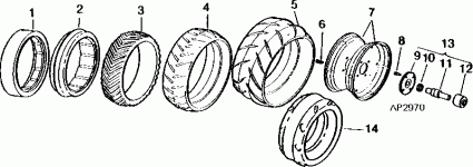

Im a new member on the site here and picked up a 71 series planter today and there may already be a thread or info out there on this but was wondering if any forum members know of anywhere online source or if my local JD dealers could get the rear press wheel tires for the 71 series planter?>>..... Any info would be appreciated!

Do you know what size they are by chance...my planter happens to have the ones with a groove in the middle with "tractor tread" pattern on the ridged part of the tire...will other styles fit mine?

There appears to be several choices of tires.
1 B16102 TIRE 1 (USE WITH C1232N) 100 MM X 405 MM (4" X 16") SMOOTH
2 B13356 TIRE 1 (USE WITH C1232N) 100 MM X 405 MM (4" X 16") RIB-TYPE
3 B31532 TIRE 1 (SUB FOR N10065) (USE WITH C1232N) 100 MM X 405 MM (4" X 16") CHEVRON
4 B27414 TIRE 1 (USE WITH B27852) 150 MM X 405 MM (6" X 16") CLEATED
5 B31722 TIRE 1 (USE WITH B27852) 150 MM X 405 MM (6" X 16") DUAL-TRACTION
I randomly picked one size of tire. B27414 PRESS WHEEL TIRE ADD 131.04 USD

Thanks for the great info guys...my tire is #5 in the photo above!
