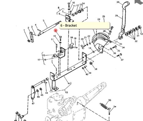

Make sure link #2 pivots freely on shaft #5. I have seen some of these get rusty and need to be freed up to work properly. It relies on spring pressure to move and if too tight to pivot, spring can't move it.
