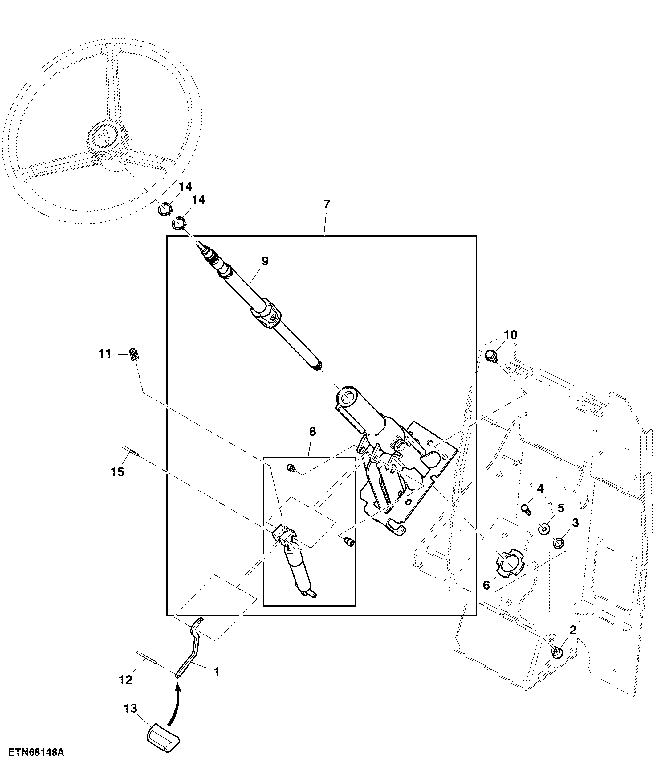

My tilt steering wheel wont stay in one place. Is the gas cylinder replaceable? If so where can I find one?
/ JD 5425 Floopy steering wheel #2
Welcome to TBN
jdparts indicates this part # is "servicable only" (part # RE212851).
See there is a kit for it here.
link
/ JD 5425 Floopy steering wheel #3
This is the PN that I find for a gas shock on a 5425 OOS. SJ10177 Cylinder Kit - CYLINDER KIT, TILT MECHANISM STEERI View/Update No Price Available
Not to sure what a servicable kit contains as I could find no breakdown picture. Would this be like a carb kit? Am I getting into a repair that I may not be able to finish? $211.00 is a bit high for a surprise package.
/ JD 5425 Floopy steering wheel #5
SJ10177 is parts key 8.
HTH's,Jim

any suggestion how to get the pins out of the piston holder . Mine wont budge either top [ allen wrench ] or bottom pin . i was hesitant to bring the heat . thanks
/ JD 5425 Floopy steering wheel #9
If loctite was used sometimes heat is required to loosen screw.
/ JD 5425 Floopy steering wheel #10
they must have used it as i had to create a breaker bar out of a draw pin and my 200 lbs . I could not get the bottom pin w/o cutting it out and using a sledge and punch . Thank you
