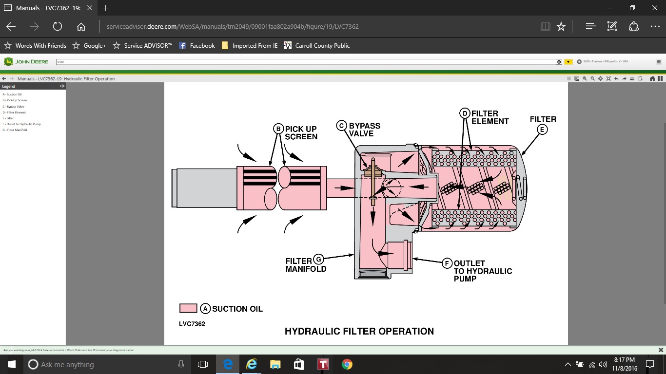

Another thing occurred to me. There is a bypass valve in the hydraulic filter head. I have never had one out - it is not replaceable. Deere only supplies complete filter head. Here is a diagram from tech manual. If valve is missing, it would allow unfiltered oil too be drawn past filter and into the pump.

Still no luck. John Deere hasn't come up with an answer either. I'm debating on whether just to put it back together but I would hate to find out later that it's something that needs replaced and have to tear it down again.
   / JD 5420 Transmission part ID
#17
Finally got it figured out! There is a connection on the side of the transmission case that pipes to the mid mount scv that is actually a check valve. Pulled it off and sure enough the guts were gone out of it. It's number 12 in the diagram. Thanks for all the suggestions guys. View attachment 5420 cv.pdf
