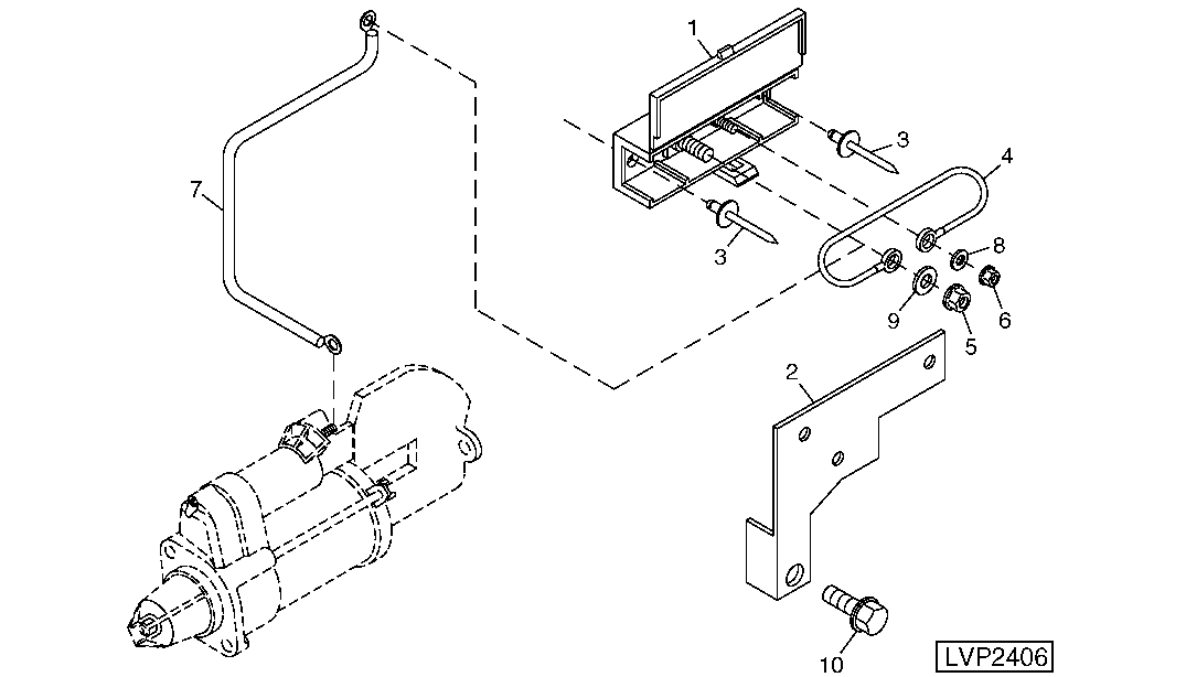

Hello all
Basically:
Battery is good.
There's power coming to and from the ignition terminal on the ignition switch. But, no power making it through to the solenoid.
No fuses blown
PTO indicator is off.
I can't find a wiring diagram for this online. I'm assuming there's a few relays and safety switches that could be the problem, but without a wiring diagram....
Any body know what the issue could be? Before I start manually tracing wires.
Thanks
Jon
/ JD 5420 Not turning over #2
Check this fusible link. Is trans in neutral?
looks like that assembly checks out. Power is there. And jumper is conductive.
I checked the trans position switch. Seems functioning, but no power coming to it.
Must be a relay or something between there and ignition switch. Still haven't been able to find a wiring diagram online.
hey thanks for the help. I had checked the battery.
So far, it looks like I was wrong in the assumption that PTO indicator light would tell if the actual PTO switch was closed. Must be a two position deal. Fine dirt had packed itself in so hard, it eventually wouldn't let the ignition circuit connect. Only the light.
So, for now it's working.
Thanks everyone. Especially that wiring diagram.
