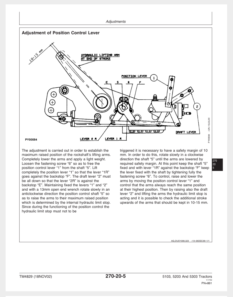

I want to adjust the range of movement of the rock shaft/three point lift lever. I believe the range is from 1 at the bottom to 6 at the top. It seems I am primarily using the 4 to 6 range and sometimes I need to adjust my top link when using rotary cutter to lift higher for transport and adjust again when mowing to get the range of movement I want at the hitch.

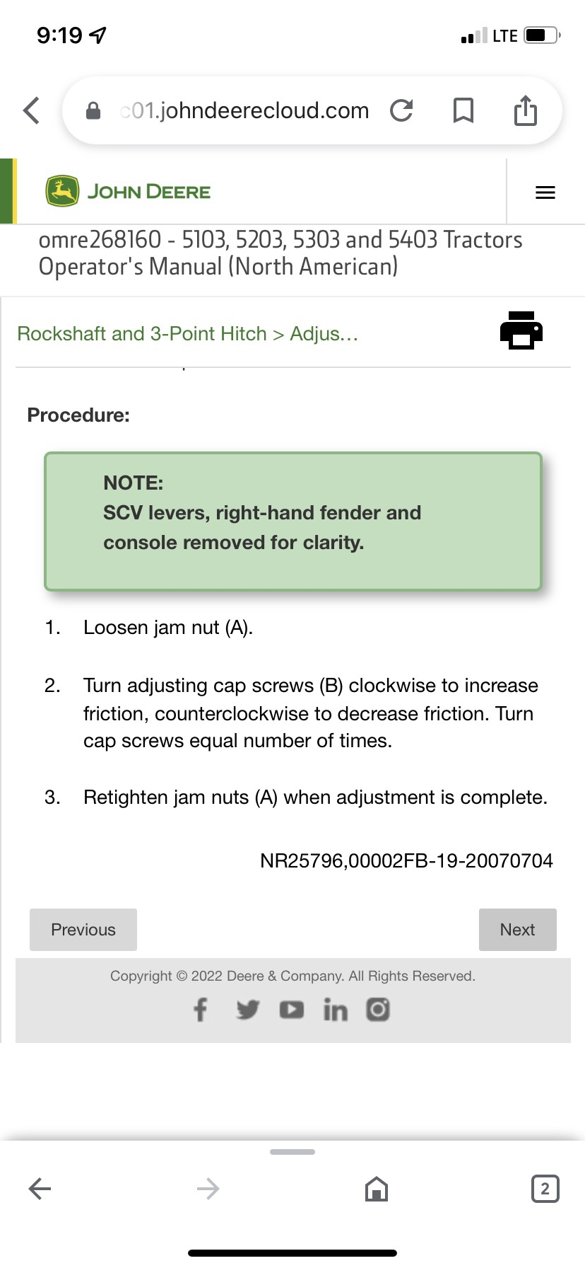

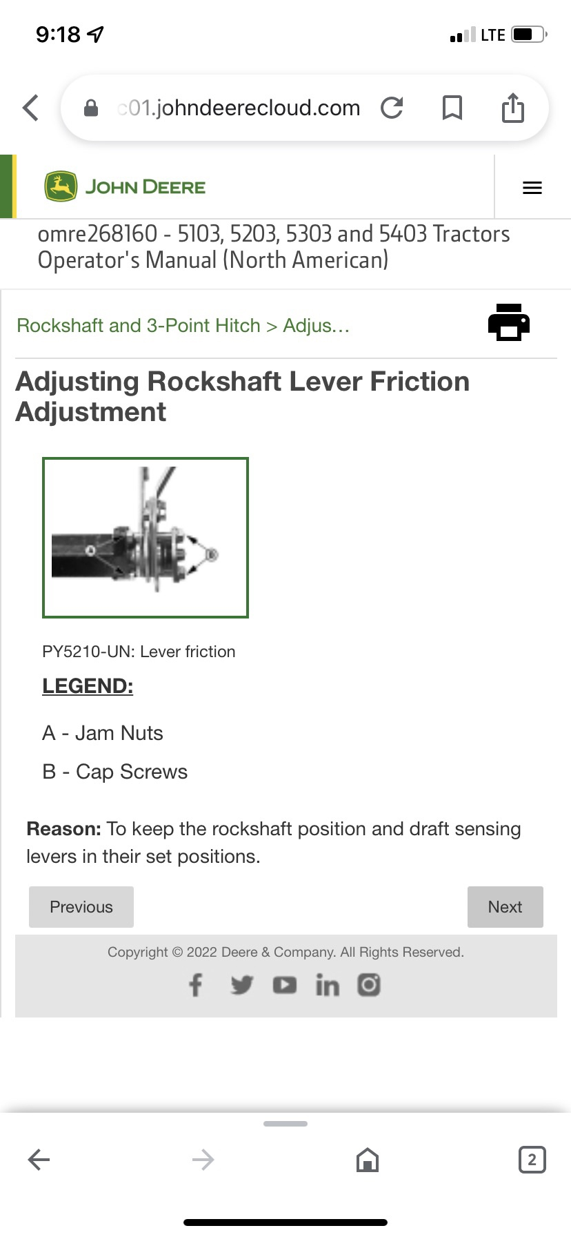

I came across this information that describes how to adjust the resistance on the movement of the lever:
Thought this might be the place to adjust by loosening and moving the lever down some and tightening back. I did that and just doesn’t seem like it changed much if any. I moved it from 4 down to 3. My thoughts were to get it where the mower is on the ground at around 2 and that would meet my lowest setting needs and might give me more range to lift and not have to adjust top link each time.
Am I missing something or does that make sense and sound right?

Those bolts only adjust the friction on the lever. Tighter = more friction and more force needed to move the lever. Looser does the opposite.
I don't think you can change the actually range of motion of the lever as it is preset from factory to go to the lowest position and to the max position.

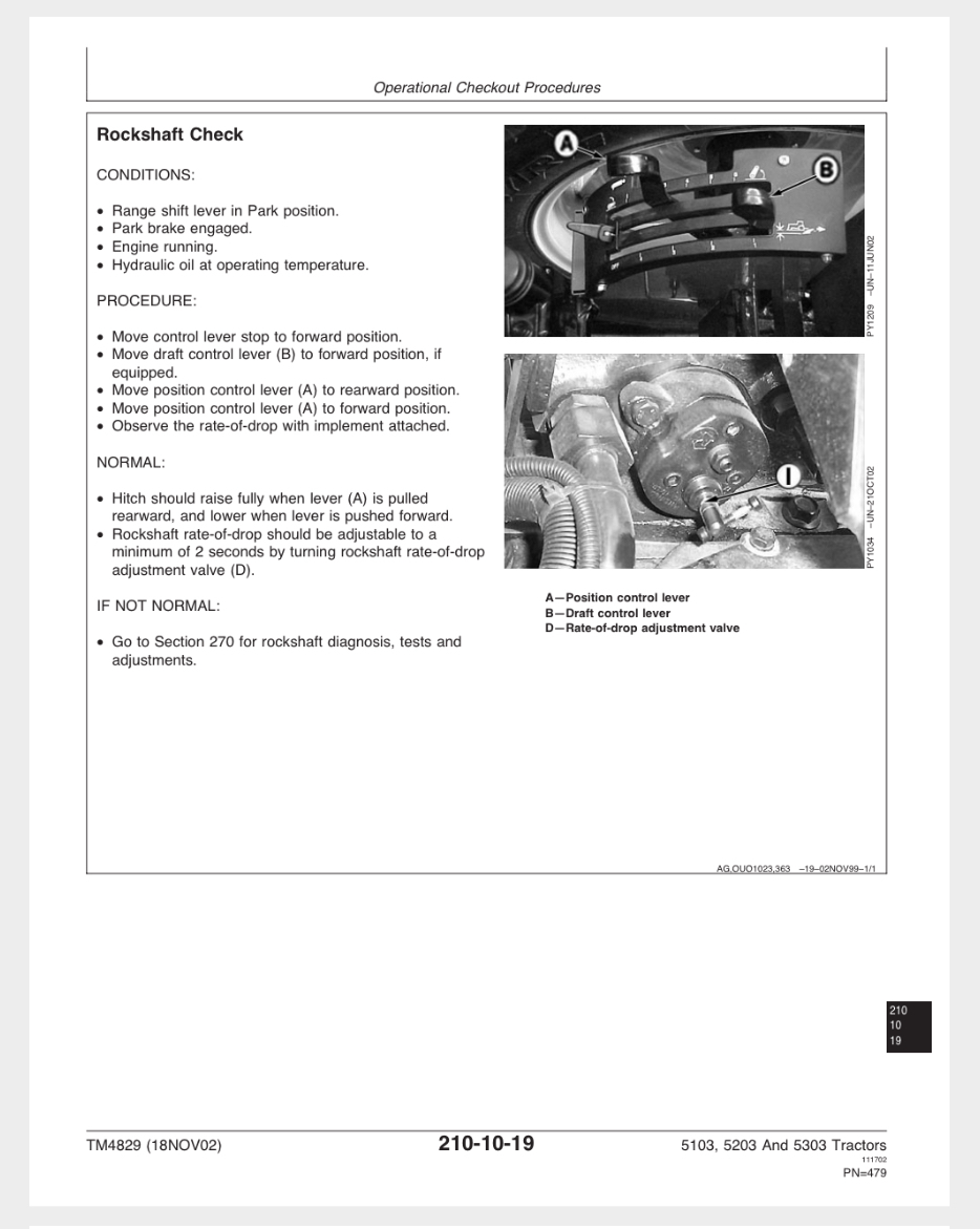

May be that the cover doesn’t have to come off. Looks like this procedure lets you set the top limit and go from there. Not sure I need to reset or check upper limit travel. Only wanting to lower lift lever couple spots to increase range of movement. I suspect this procedure helps insure everything is checked so nothing is overlooked.

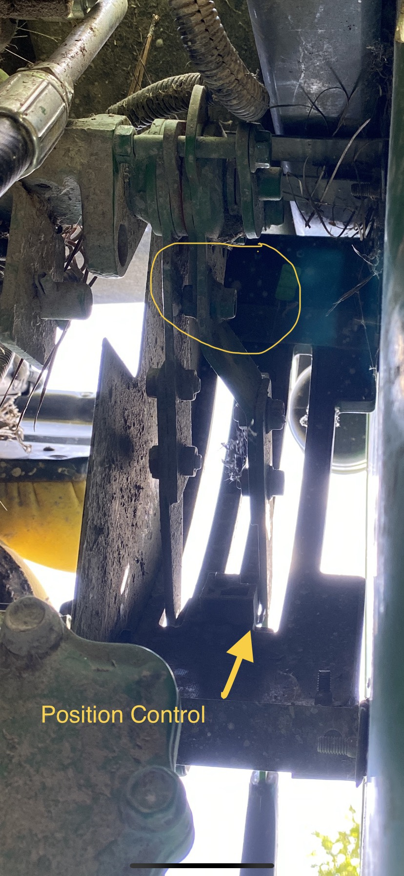

Here is picture from underneath. Looks to me like the two bolts only join the two pieces that make up the lever together. Don’t see how they can adjust. Looks like they come apart so cover can be removed. In looking at picture I do see another single bolt that may could be loosened and would allow the lever to move/adjust. I circled it in yellow. Is that what you loosened and adjusted?

Loosened the two bolts and the single bolt. None allow the lever to adjust or move other than all as one unit. Sure looks like there is no adjustment.

Loosed the two bolts and the single bolt. None allow the lever to adjust or move other than all as one unit. Sure looks like there is no adjustment.
The later units' levers have slots instead of round holes in the position control lever so the travel can be adjusted there, rather than the method the service manual you posted details. I don't have a 5xx3 series tractor, but since mine is the successor to it, I thought it was worth a shot to see if your adjustment was the same as on the newer models, but unfortunately it is not.
If the arm travel is correct, then you may want to shorten the 3 point lift links on both sides to increase lift height. This will lift the draft links higher at all lift arm positions. If you want to truly expand the range the draft links travel, you would need to replace the lift arms with hydraulic cylinders (e.g. two "tilt" cylinders from a top and tilt) in order to further raise or lower the draft links when the lift arms are fully raised or lowered.
