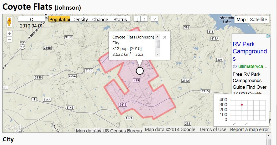

   / JD 5210 milky hydraulic fluid
Hey guys I really appreciate all the tips and advice.
Thanks,
BJ
p.s. Where is Coyote Flats?
   / JD 5210 milky hydraulic fluid #9
It's in a triangle between Cleburne,Grandview & Alvarado. It was voted in 2010. The people that drew the city limit boundaries were smoking "wacky backy" or consuming something illegal.
