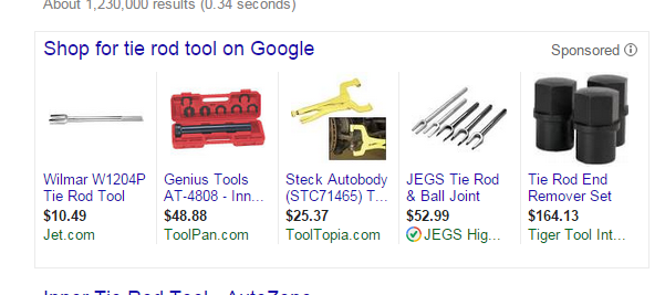

I am trying to separate the tie rod from the knuckle on the MFWD swivel housing of my 5210, so that I can replace the boot. I have the nut loose. I tired hitting hard with a big hammer the knuckle to break things loose, with no luck. I have jacking up the tie rod a little and then hit the knuckle with the hammer, no luck. I tired using two hammers holding one on one side and hitting with the other on the other side. I do not have fork big enough. I have tired jack up the axle if maybe the tire was binding anything up. The repair manual did not provide any suggestions. I currently have them sprayed with penetrating oil.
Any suggestion on how to remove the tie rod would be appreciated. Thanks in advance for any help.
   / JD 5210 How To Remove Tie Rod? #2
You may have to resort to one of these tools.
Thanks, looks like I will need to get a pickle fork.
