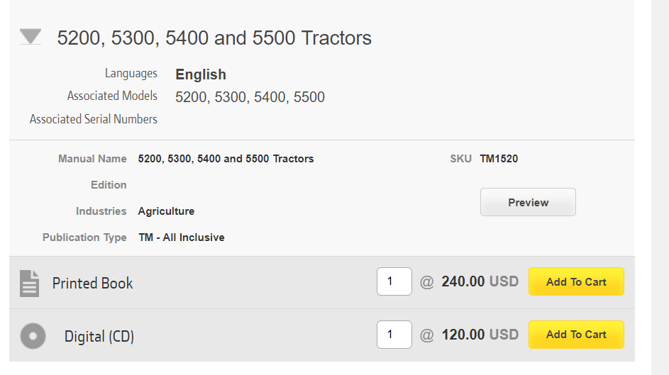

Hello,
New to the forum and recently purchased a used John Deere 5200 with a bucket, serial number LB5200E520577 and I am looking for some information on it. Yesterday I was using it and ran into an issue. I believe that I may have an issue with the fuel injector pump and need to do some repairs. What is the best option when it comes to service manuals for this? Are there downloadable versions or is John Deere the only option? Which manual is the correct one? I have looked and it seems that I need the TM1520 but I have also found these online with different years of manufacture. I think my tractor is a 1995 model. I have read somewhere that I will need to set the engine TDC before I pull the pump and want to make sure I am getting this right the first time.

John Deere tech manual will not have much info on the internal components of an inj pump. What's you tractor doing/not doing? Have you changed fuel filter lately & checked for good fuel flow from tank to IP? TM1520 is the correct manual for your tractor & I see no serial # or year model break. Printed version is $240. You need to do some good diagnostics before attempting to remove inj pump!!!!!!!!!

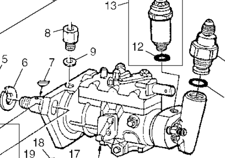

   / JD 5200 Manuals needed
I totally agree that a quality diagnosis should be conducted. Tractor has been operating fine with fuel filter recently changed and I have good fuel flow. Problem occured when I was plowing a garden. Got to the end of the row and lowered the throttle down to idle as I back up to make my final pass. I got no response when I attempted to increase throttle, just stays at idle. As I conduct regular maintenance on it, checking normal things have already been done. I still pulled the filter again just to make sure as well as follow all linkage from throttle handle with no success of finding a failure. Must be something inside the pump, a spring or what not.

My guess is check valve(key 8) is clogged up which causes too much pressure inside of IP. Disconnect fuel return line remove valve then start engine to determine if it will accelerate.
