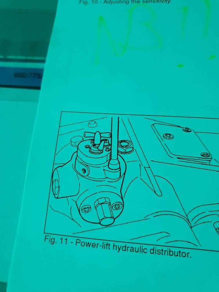

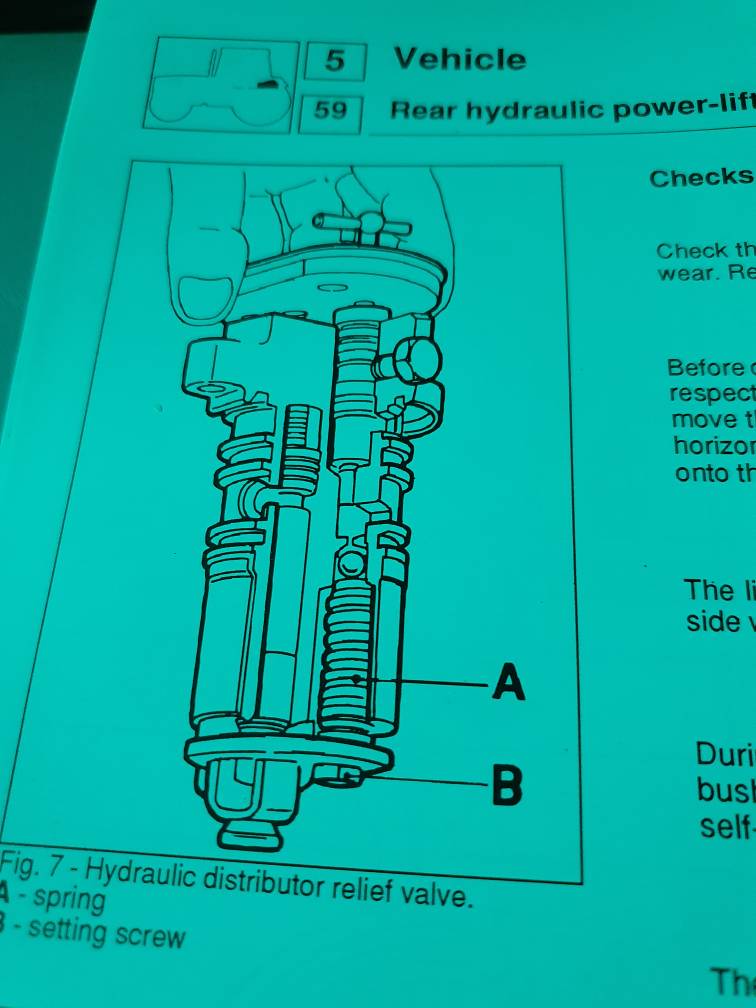

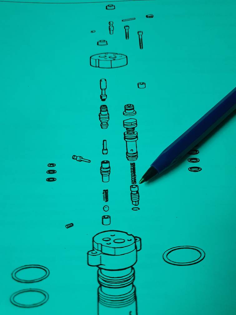

   / JD 5105 Rockshaft arms stuck in up position #4
Did you get it going again ?
If not
Get your tractor under a gantry and lift the impliment with a tackle til there is no downwight on the arms.
Then you remove that valve.
This pic is from a Same but the hidge is a Mita.oil will spill so be ready for it.
Now you can start stripping the valve by remocing its topcover.
Then removing the valve with the 2 flat sides. Clamp that 2 flat sides in a vice and check if that inside spool is stuck (grain of sand or a little twig) undo the rest of that valve and remove that spool.
Polish it and reassemble it .
By wake-up how that flatsides was standing before you removed that valve and put it back the same way it was !
Ontop of the valve is 5 allen- head screws. Only unscrew 3 that is standing the same. The other 2 is an adjustment . Do not tauch them .20200710_130052.jpeg20200710_130031.jpeg20200710_125958.jpeg

That adjustment is to set your rate of drop. If close it will stay in the up posision.when completly open your impliment wil fall an not lowering at a steady rate.
   / JD 5105 Rockshaft arms stuck in up position #8
Do not do that adjustment ! Its for the sensitivity of the lever !

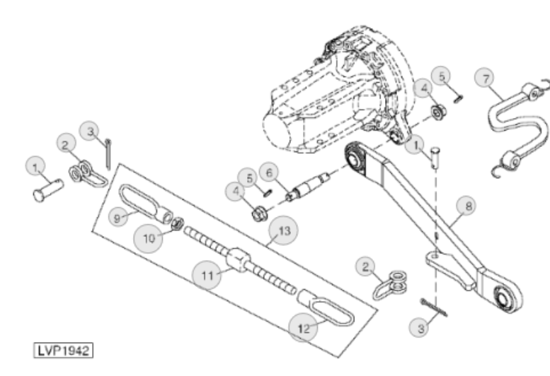

It turned out that the Rate of Drop Knob "K" did not help the situation. I ran it from one end of adjustment all the way to the other end of adjustment and it did no good. In the meantime, I discovered that the sway chain links are in a severe bind and extremely tight. At this point I suspect that I managed to get the mowing attachment moved so high that the arms and sway chain links are the problem. My son and I are trying different methods of getting enough looseness somewhere in the system to allow us to get those sway chains loosened enough to permit things to move. At 77 yrs. old my physical strength is not where it used to be. My son is in his 40s now and much stronger than I ever was, so we are working the issue together. He has to do some other tasks over the weekend, so we will tackle the problem again on Monday if all goes well.

   / JD 5105 Rockshaft arms stuck in up position #10
Are your sway control links like pictured? You might be able to remove the pin at either end.

   / JD 5105 Rockshaft arms stuck in up position #11
Or use a hacksaw on one or more of the clevis's.
