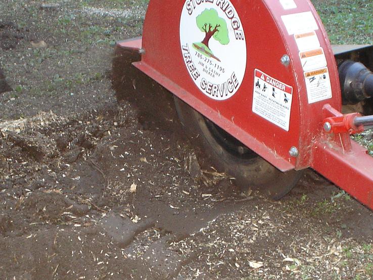

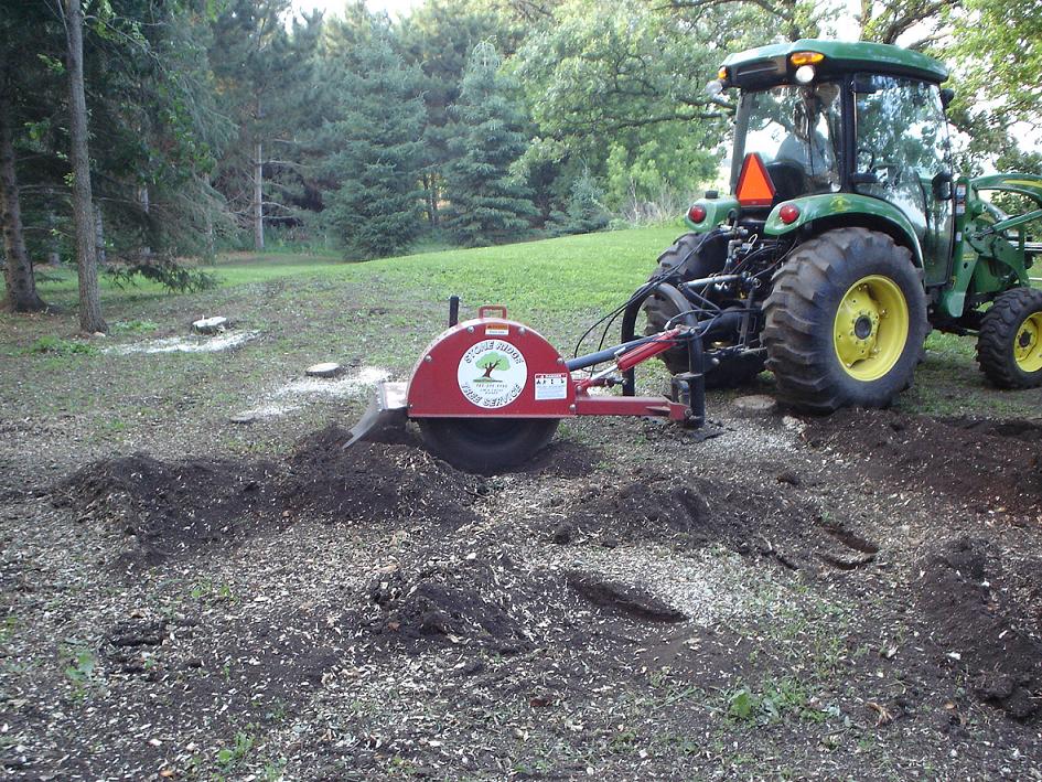

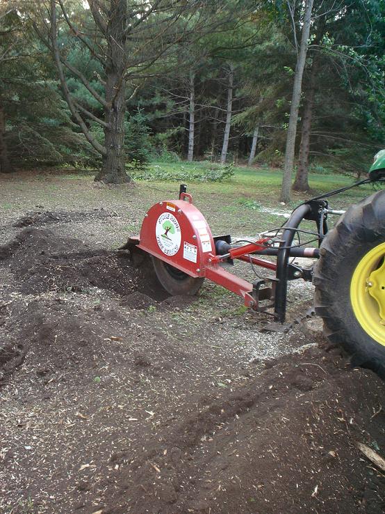

Darin, Here are a few pictures of the 4720 in action with the stump grinder. The grinder will use all of the 50 pto horsepower if I try to take too much stump at one time. Actually, its one of the few times I've made the tractor growl a little.
I picked this up on ebay for $3950. It cost me $250 to have it shipped from Kansas to Minnesota. I hadn't planned on purchasing a stump grinder but couldn't overcome the high prices all of the guys were getting here to grind stumps. I understand the need to charge a reasonable price to cover fuel, replacement parts, the cost of the equipment, and the operator's time but the best price I could get was just under $1200 for 40 stumps. I've ground 35 stumps so far in about 6 hours of time and used about 12 gallons of fuel.
I'm in the process of thinning a stand of scotch, norway and white pine and will have 40 to 50 stumps a year for the next five years. The grinder will get plenty of use and might try a little custom work with it.
