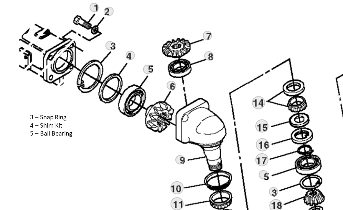

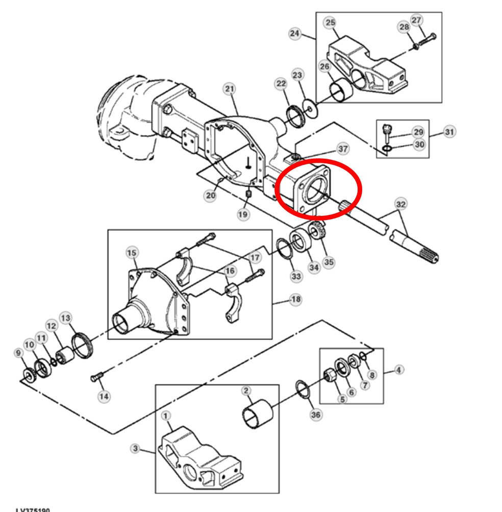

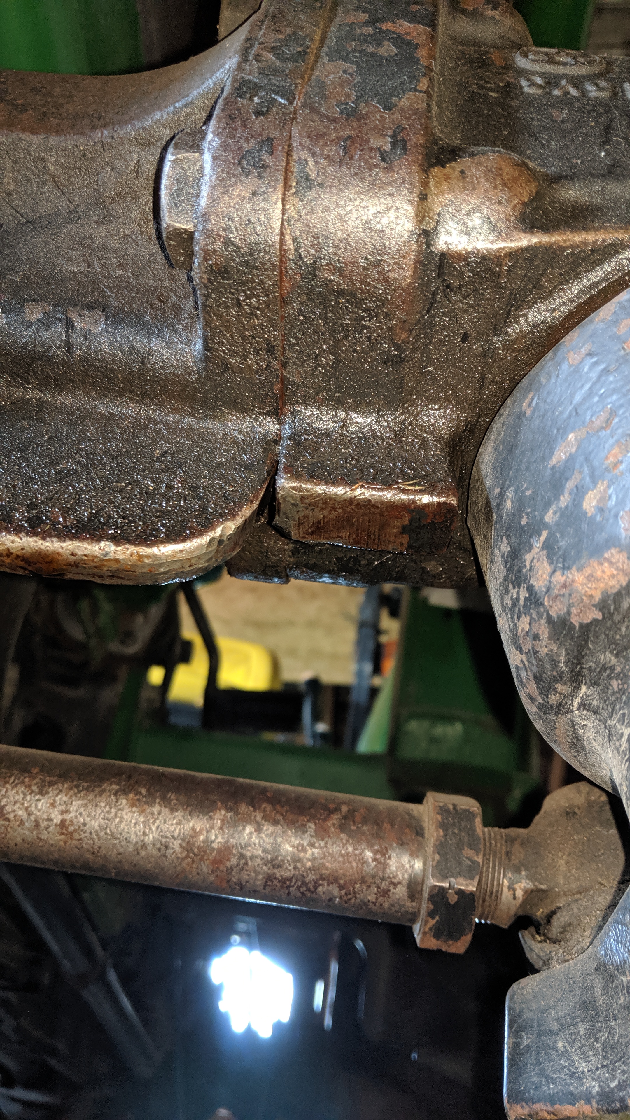

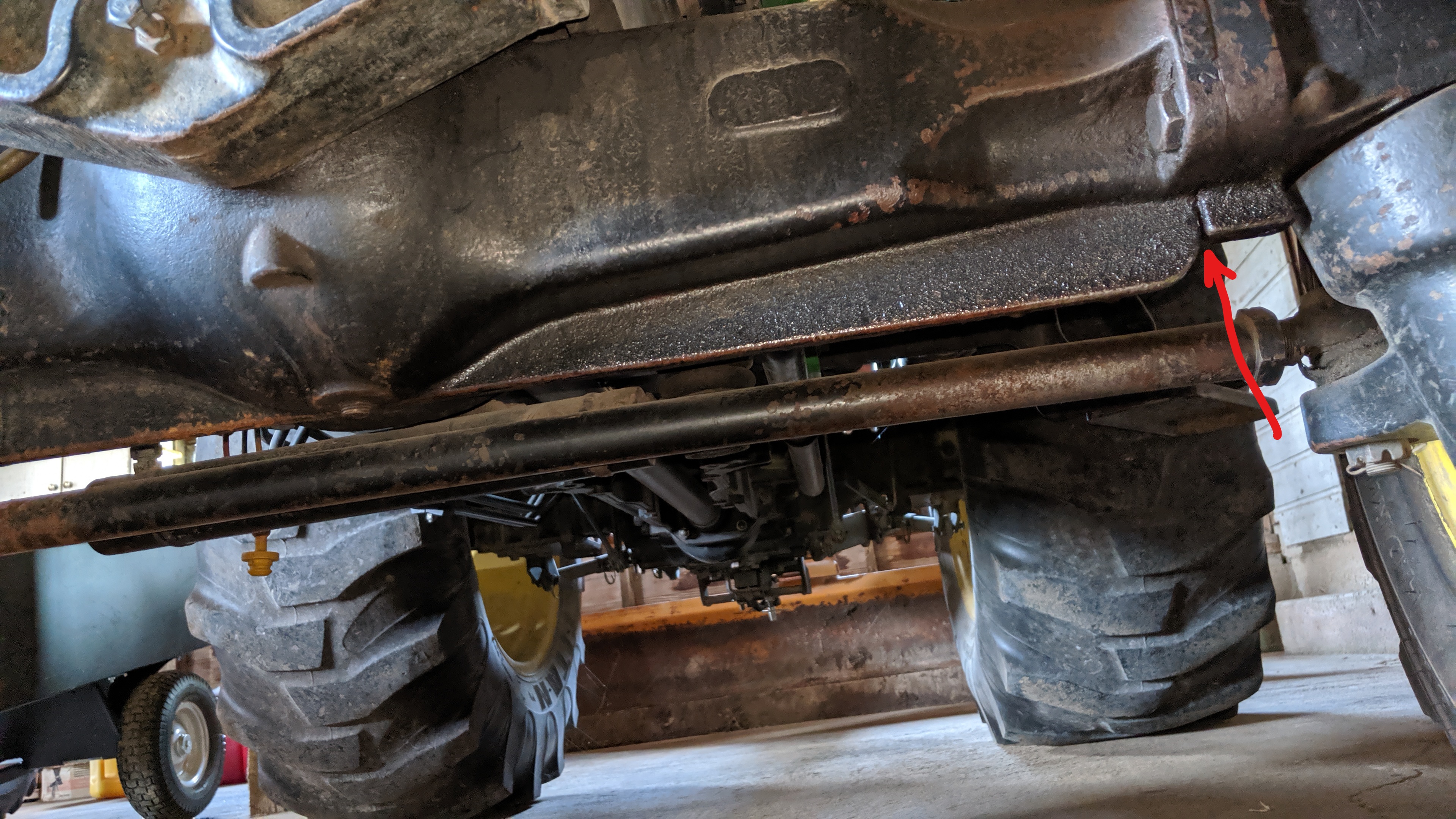

I have a small leak on my JD 4600 front axle, where the main casting bolts to the first 90° bend. It seems an oil leak right at the swivel part of the "kingpin" on the 4x00's is pretty common, but I haven't been able to find much on this location. Looking at JD Parts it appears there isn't any seal at this joint??? Anyone had this apart or know where I should start for fixing? Bolts are tight, oil level is right at full.
   / JD 4600 Front Axle Leak #2

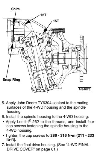

I've had mine apart. Used a small bead of silicone and make sure the bolts are tight...and stay tight.
   / JD 4600 Front Axle Leak #3
service manual calls for "sealant" I have a PDF of the manual you're welcome to, shoot me your email if wanted
joe
Looks like this is pretty straight forward.
Joe - thanks for the offer but you already sent it to me in March :laughing:. Guess I should look there first next time. Thanks guys!
