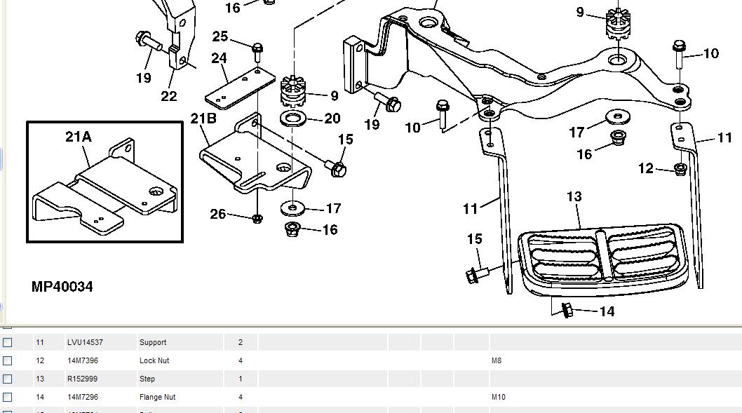

My dad is having a hard time getting into the cab does anybody make a second step for that tractor or a solution. We don't use any mid mount attachments.

Is this the step you have now? (removed pic as it was the ag 4520, not the CUT)
If so, seems bolting on two straps to each side, and a bar across the bottom would add an additional 3rd step.

No it's a single step 2012 cab model

Didn't know it was the compact utility 4520, rather than the larger ag tractor. Sorry.
I now see the single step. But you may still be able to add straps on each side that extend to a step. In fact, look at the step for the non-cab 4520 CUT in jdparts, and maybe just buy the parts and bolt them on. Parts #11 and #13 in attachment.
A pic of what you have now would be helpful to assist in a better design.
