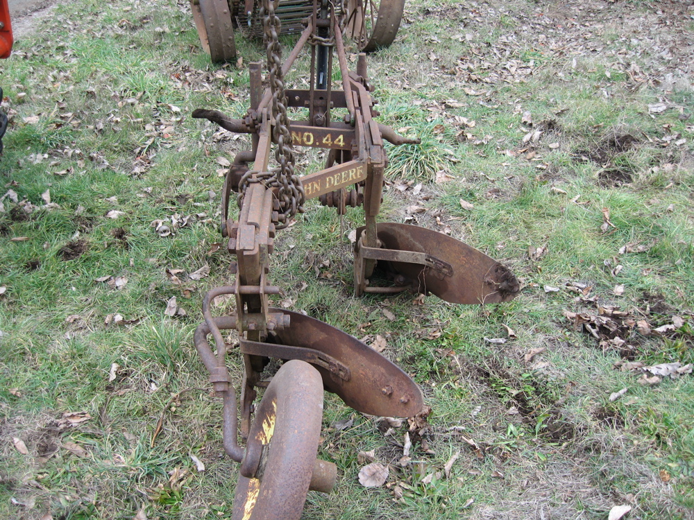

i was checking out another plow, i think it was the 44 with wheels and it looked like it had the same plowshares.

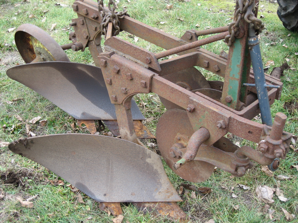

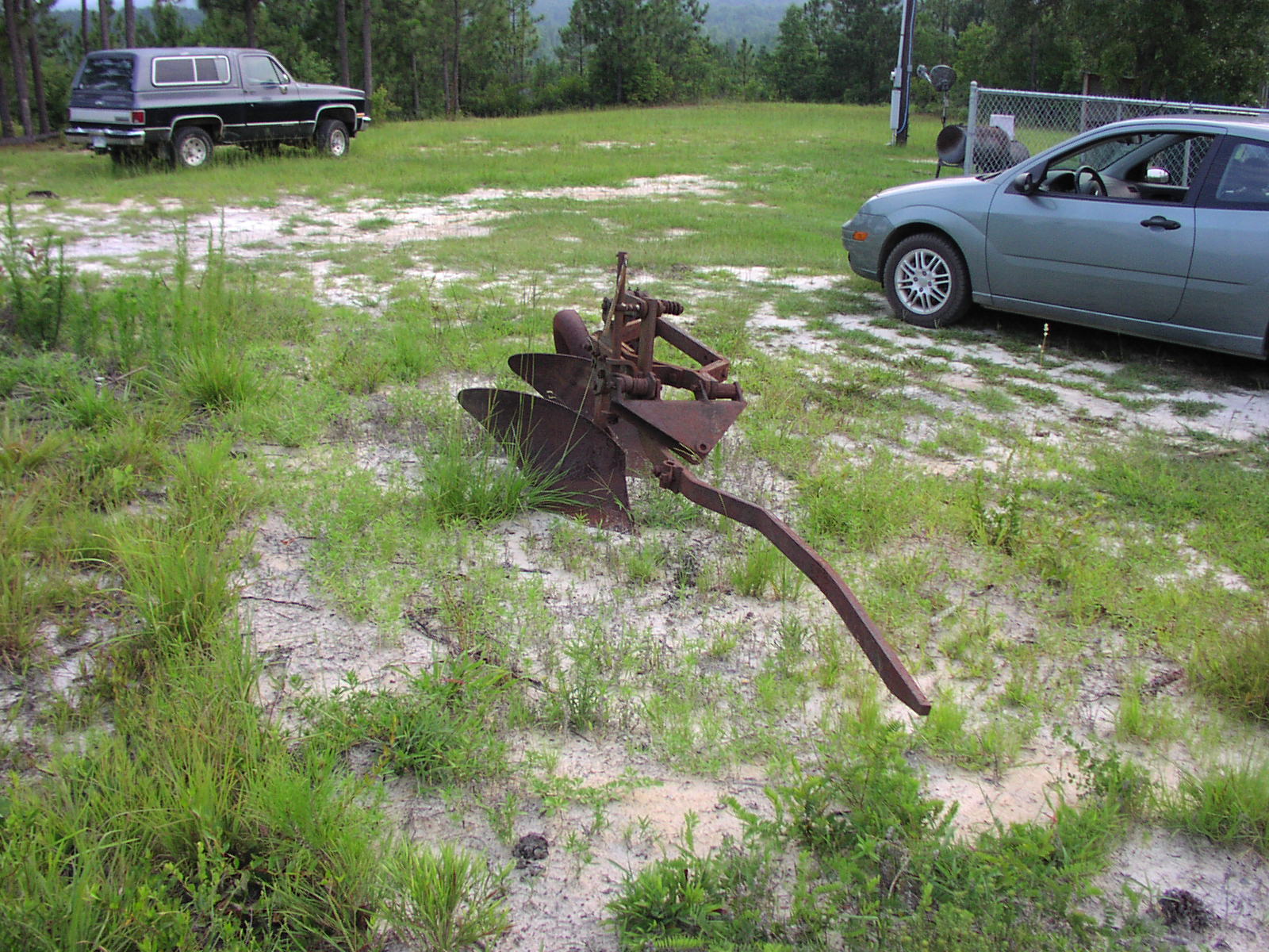

Here is a picture of a BC with wheels . I found this on the internet .I think the plow you have is the one up from the one I have .Mine is for a MT and I think yours is for a 430. If it is then it will take the same Share as mine. I will try to have the numbers for it in a day or so. Here is a picture of mine.Same thing you have but yours is newer then mine is.

thanks for helping, Gizmo, did you make that plow?
/ jd #44 plow shares #7

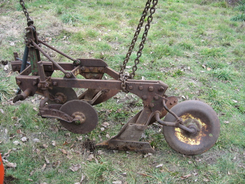

It when on a MT john Deere .I am trying to make a 3 pt out of it.

No yours came that way , it looks just like the 3 bottom. I would like to see some picture's of the front of it. When I am done with mine I can run it as a 2 or 1 bottom plow.

On a MT the Drawbar HP was 14.08 Engine was 18.33 HP The weight is 2,550 lbs Now my Yanmar is Engine 25 HP the weight is 2083 It weights 467 more then my Yanmar 2210 The MT is 125 long The 2210 Yanmar is 110 The MT is 15" longer, that is a lot when it comes to a tractor . Now I know from years ago that the MT would pull the 2/14 easy. Now I no the newer one's pull like a anchor .I put it to the 2210 and it pull it easy in hard clay. Now when I am done and it is a 3 pt .It may pull like an anchor we will see. .When I get done I may have a peace of junk it may not pull too good .Farmwithjunk the one he has the shin and the moldboard is one peace I think.

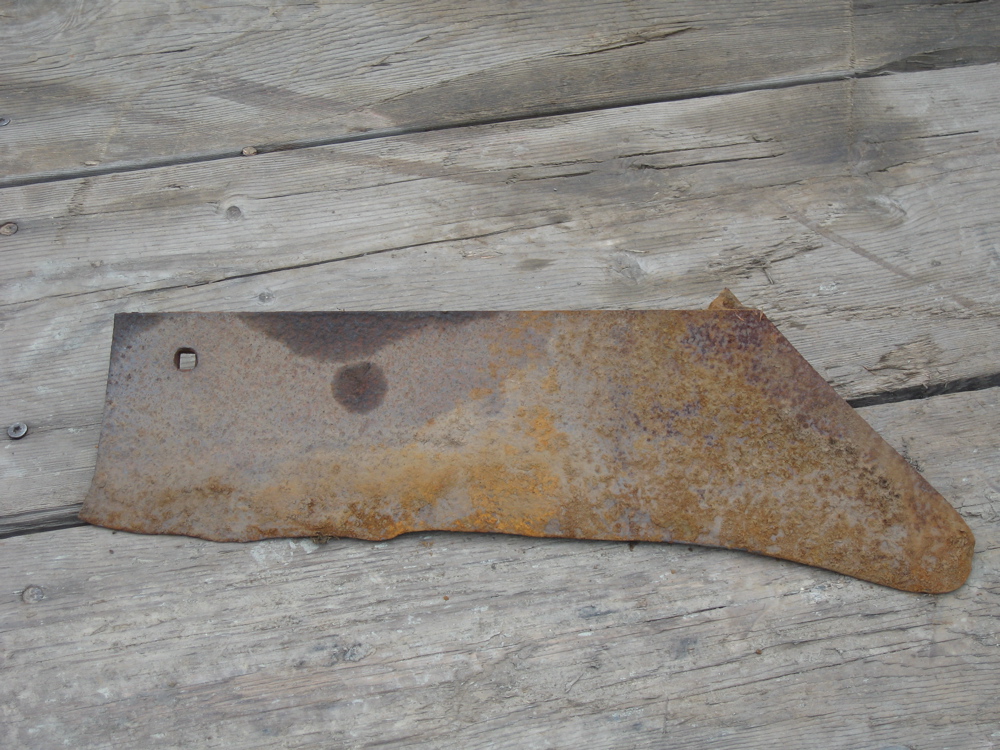

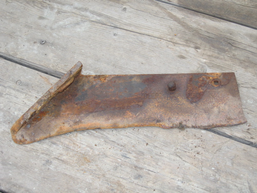

my plow is 2 piece(share and moldboard)
there is one hole for a plowbolt towards the rear, a nipple in the middle, a slot near the point.

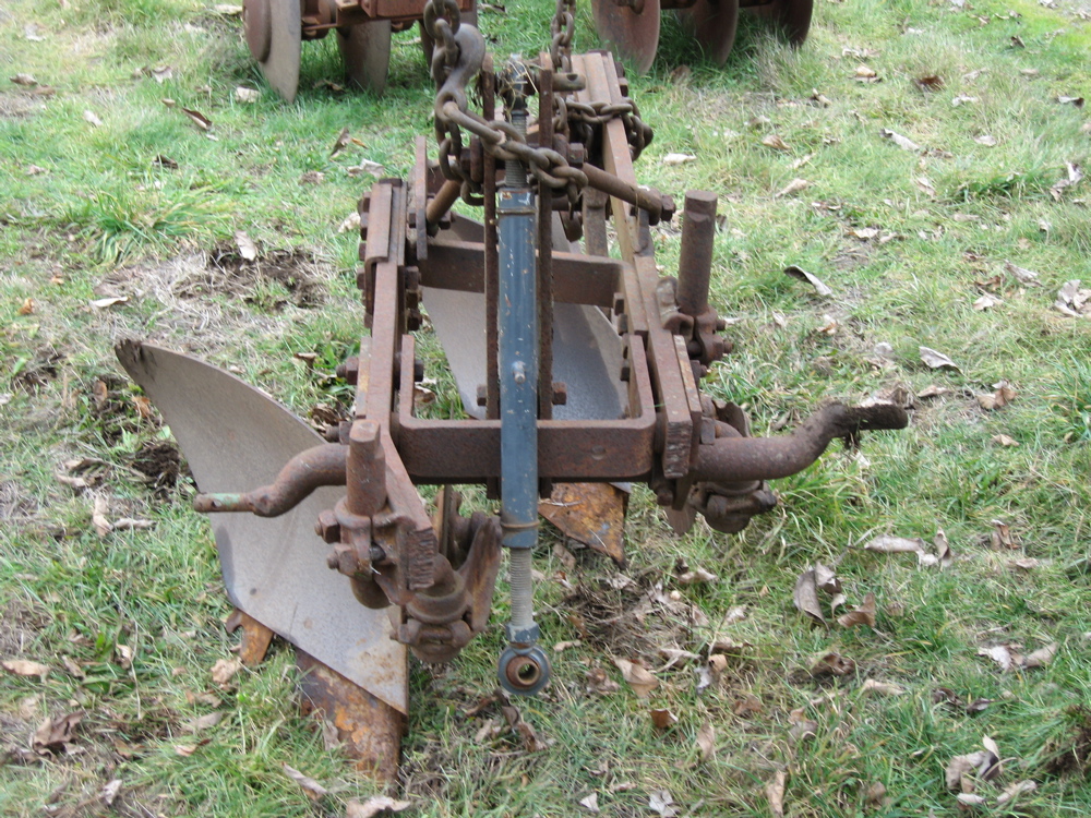

here are some pictures of the plow

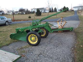

This is the way your plow look at one time .Some one has done the same thing I am doing.I wish I had saw your plow before I started on my plow . I would have use the bent piece at the end like they did .
