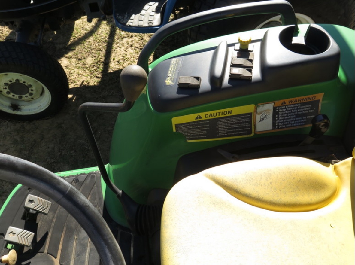

The cutout for the second switch is not in the console on the standard cruise control. The JD parts catalog reads "Remarks AUTOMOTIVE CRUISE CONTROL (INCLUDES PARTS MARKED (A)) (ALSO INCLUDES LVA11253 HARNESS)"
EDIT: I see an "A" by the parts in the list. Looks like it will just be the two switches and the wiring harness required. Guess I will have to cut my own hole for the second switch.
I was talking about the side console. I missed the dash console part.
/ JD 4320 hst compact #23
Yeah the side console on the standard cruise does not have the hole for the second switch. At least not on my tractor. The second hole in the parts diagram is dotted. Not a big deal. I can cut the hole with a dremel.
Sorry Mallard1! Didn't mean to hijack your thread talking about a different model.
/ JD 4320 hst compact #24
When I added mid pto to my 4410 I had to cut out the hole for the switch on the side console. There were marks underneath to guide where to cut.
#25
Ok, didn’t realize you were looking at a different model, my tractor has 4 cutouts with just one being used now. Should be as simple as knocking out the plugs.
