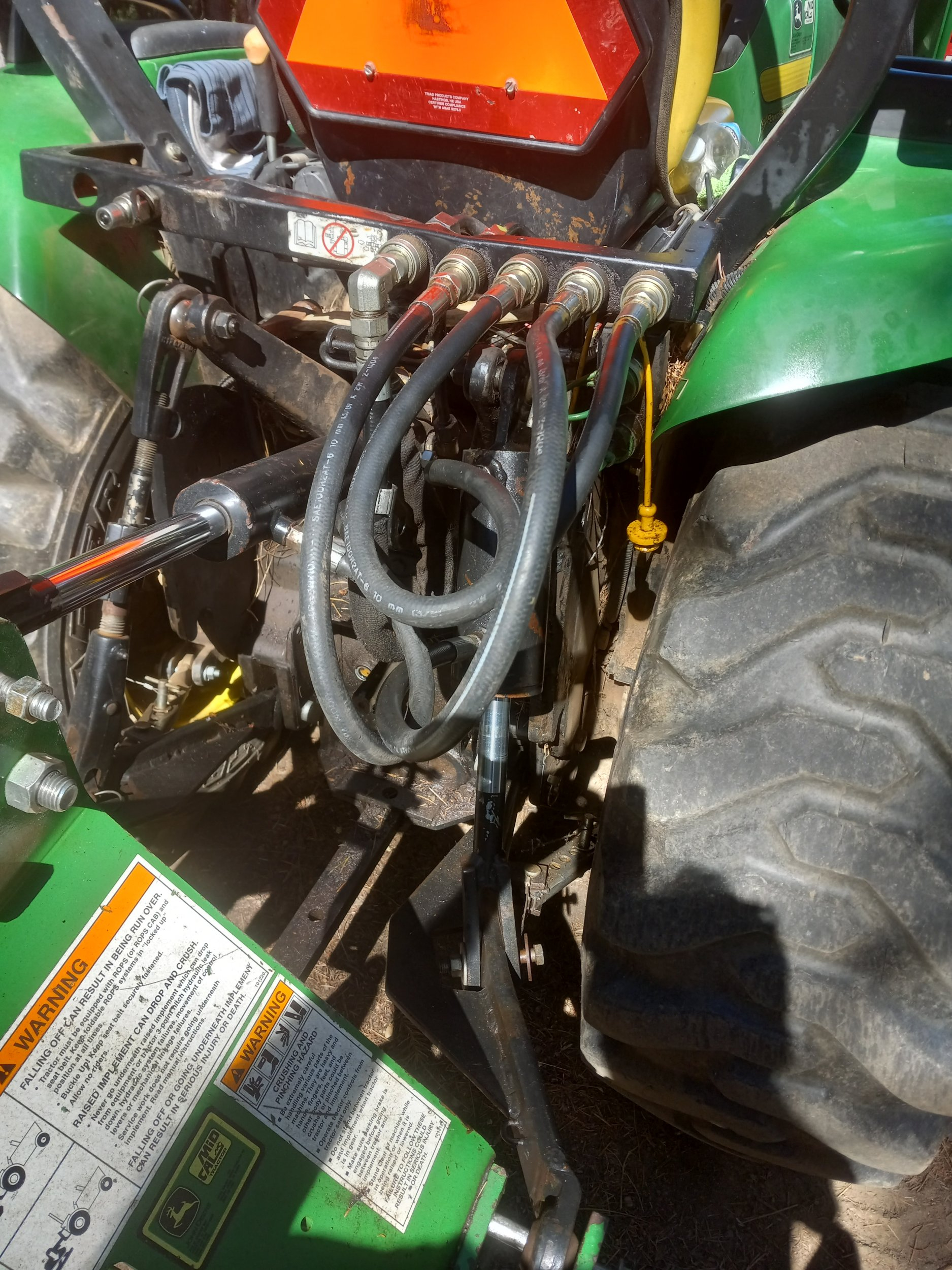

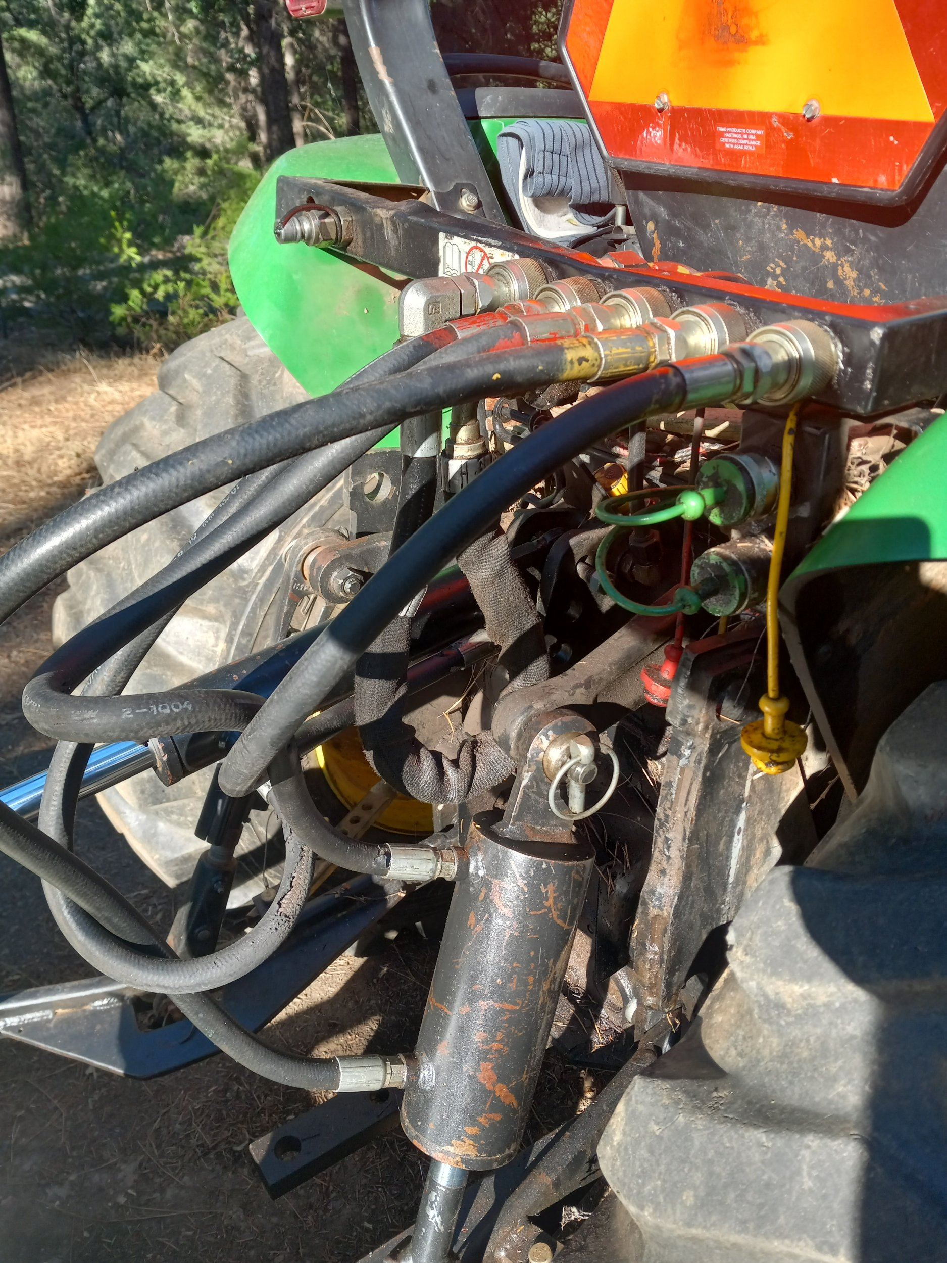

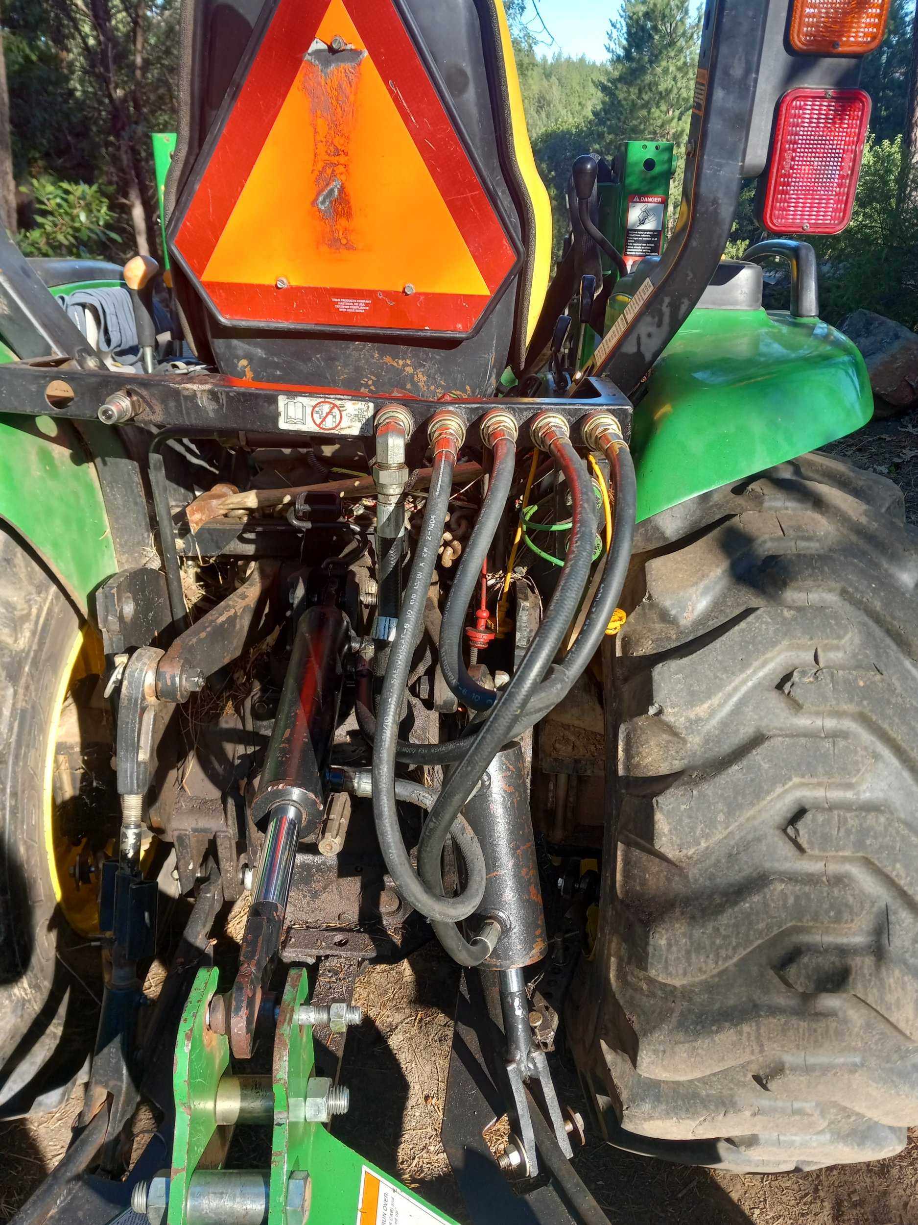

Thanks Guy's for responding , I'm sorry for the late reply .. Been slammed ..Anyway as you can see from the pics I've got two rams one for to articulate the scraper up and down ..The other to tilt the scraper at an angle for fine tune grading .I have a electronic valve that diverts the fluid from the front end loader to the back hydraulics and you can see that they are color coated .The ram that tilts the scraper up and down appears to be working , Jumpy but working. The other one just jumps a little but no go .I tried moving hoses around , Still no luck, The fluid is at proper level . Here's a clue, When I go out in the morning and start the tractor. I was hoping it would magically heal itself, the one I'm having problems with will work one time then freeze up .Maybe air in the lines ? Ideas? And I have taken the lines of the couplers to make sure they were seated .Thank You Don

Pretty confident you have hoses wrong.
Looks like your top link cylinder is the outer two hoses and the tilt is the middle two.
Each cylinder pair of hoses should be side by side on a pair of couplers
   / JD 4310 hydraulics question
You nailed it ! I don't remember it going like that. I've got a red one going into a yellow and a yellow going into red . I always thought they were color coded for a reason .Like I said it's been a year, But hey it works, Thanks so much ! Don
