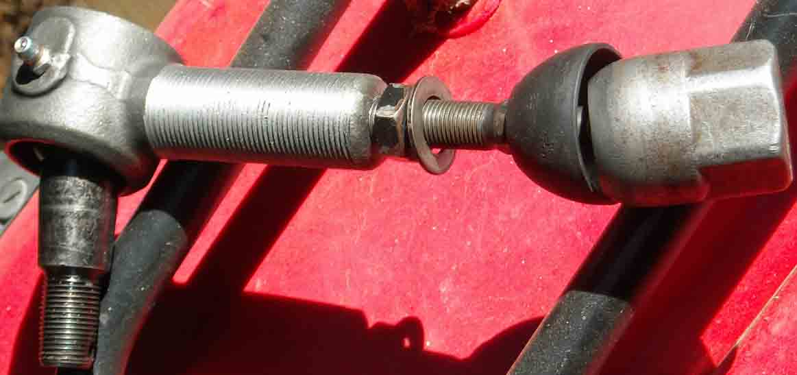

I'll take the cylinder measurements tomorrow and order a surplus center cylinder to fab. Compared to the bucket cylinder fab job I did this will be a walk in the park. Any reason I should buy new the rod ends rather than cut these off the bad cylinder and reuse? The tie rod ends are relatively cheap so I don't care either way.

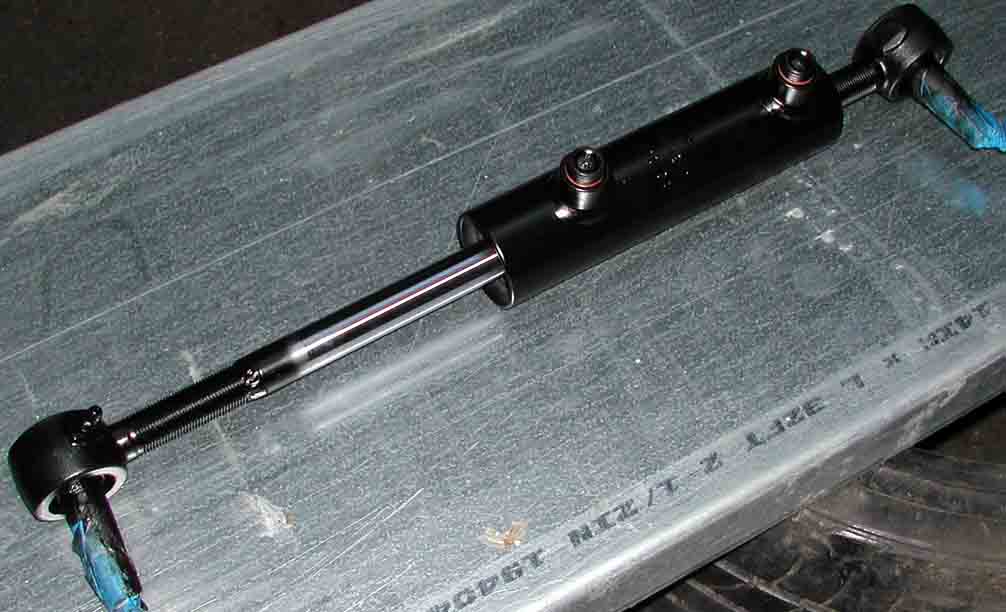

Cheap? Really? The tie rod ends for the earlier 4300 PS cylinder were hideously expensive. I went with a
tie rod end from a large truck, drilled and tapped (photo). If yours are still good, cut and weld.
The one-cylinder design you have is much simpler....I thought the cyl was welded (ugh). My 2001 was OK. The
dbl-ended cyl design requires ball pivots at both ends, before the tie rods. That's prob why JD switched.
So sorry for the confusion... When I said cheap I was 100% referring to aftermarket tie rod ends like you used. I didn't even look to see what JD charged for the ends. The ends on mine are fine. I'll re-use what I already have then. Keeps it simple.
