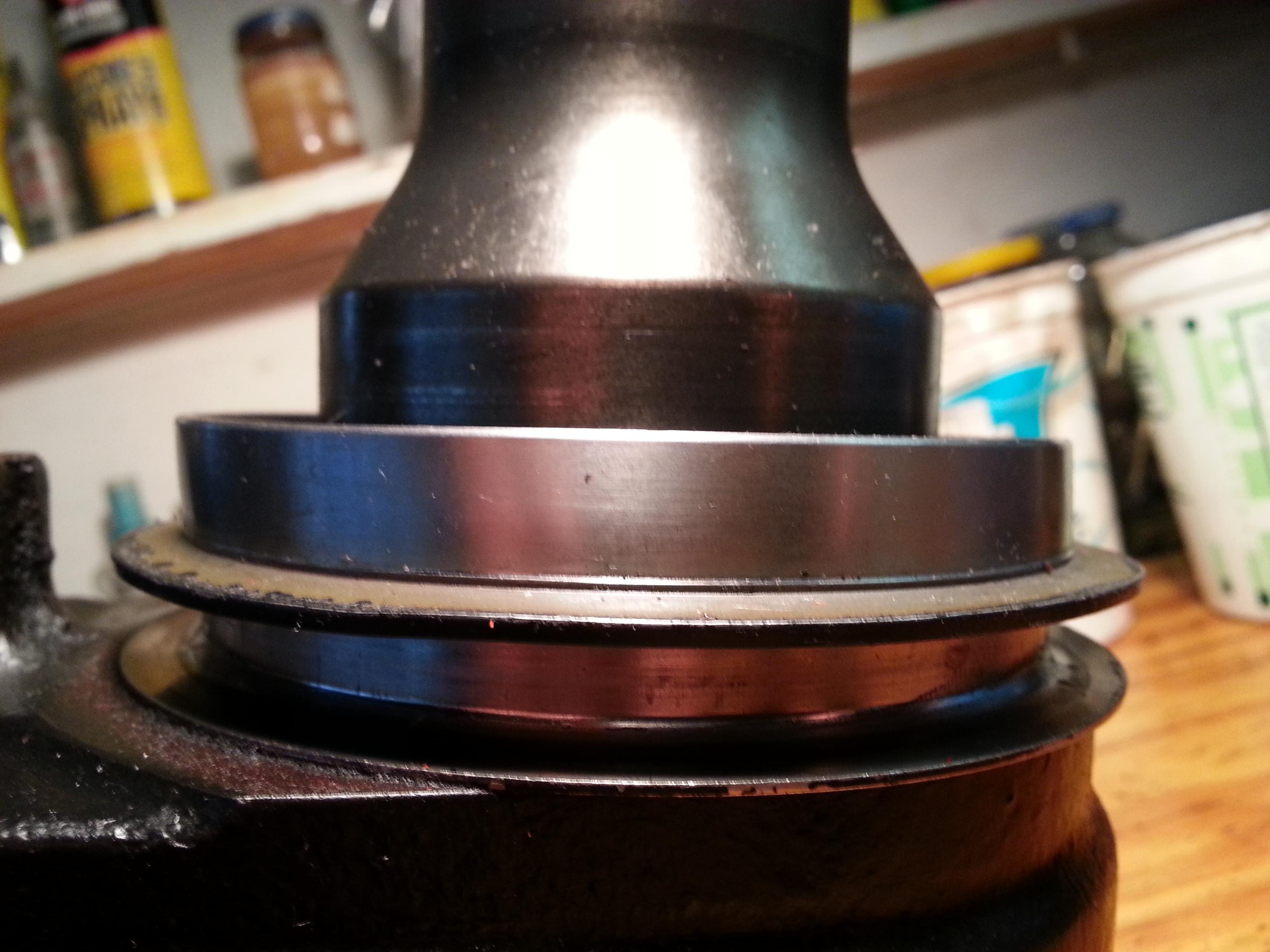

This is the piece that I'm having trouble pressing on. Does it look familiar? I read on another post about prepping seal with solvent.
That sure does not look to be all steel. Certainly lube it up well with oil first. Can you put the housing
in the freezer for a few hours first? I would not heat a seal with rubber in it over 200F, but every bit
helps.
helps.

Its steel with rubber coating in the area that mates with the housing. The rubber is likely to form an oil tight seal to keep fluid from leaking. That's what I was thinking housing in the freezer and baking the seal to 150F-200F. Will try heating the seal I ruined first to see the effect.

By your picture, it appears that the old part is still on the casting. Can you get a photo of the casting without the new seal on there?
I put the new seal on the housing to demonstrate. My housing looks the same as post #8 picture #2 in dfkrug's post.

I finally solved the problem and its a little embarrassing. Part of the old seal was still on the spindle. Once I removed it the new seal went on with not to much trouble. Thanks for all the responses. Only did the side that was leaking so most likely will be doing the other side in the not to distant future. Strongly considering adding axle ventilation. Had to change the pinion seal last year likely do to excessive axle pressure.
