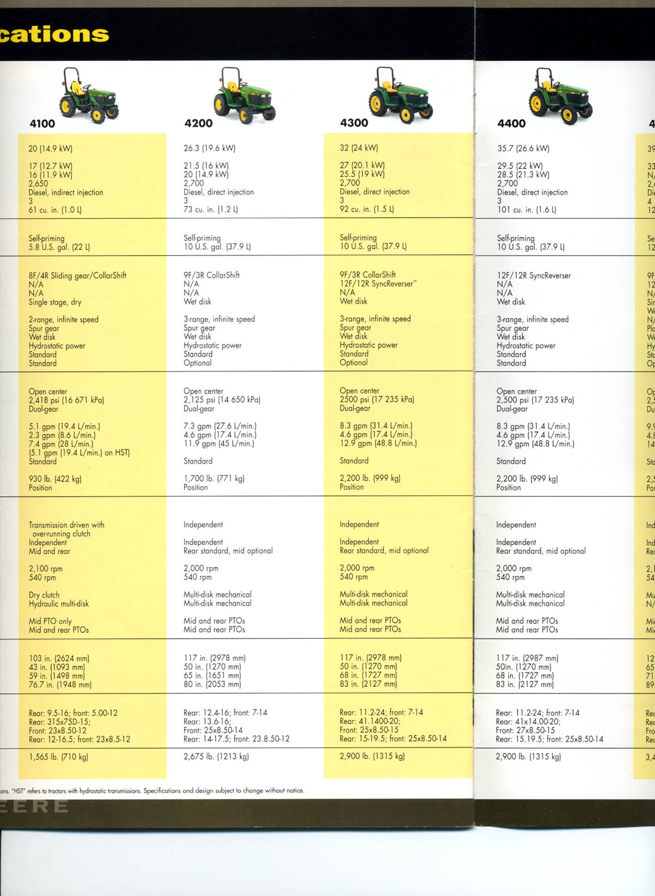

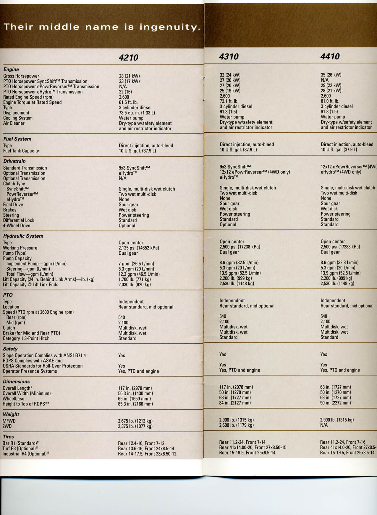

While the 4210, 4310, and 4410 are all considered mid-size frames, the 4210 wheelbase is three inches shorter. It also weighs 225 pounds less than the others, along with the previously mentioned smaller hydraulic capacity. Other details are attached, although there are errors on this chart I believe the wheelbase and weight to be correct.
I added a data sheet for the 4200 to help sort through the errors. JD has always been terrible about no proofreading on their information.

I see I was looking at the 117" length, and not the wheelbase. So you are right that the 4210 is shorter wheelbase. And jdparts has a different frame number for the 4210 than the 4310 and 4410. So there is a difference.
I've also found some gross errors in my 4300 manual. I've found the CD tech manual to be pretty good. So far. :)
