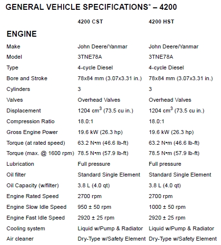

Oct 7, 2010 / JD 4200 #1 W WIJohnDeere855 Member Joined Sep 13, 2010 Messages 28 Location Wisconsin Tractor 1993 John Deere 855 What Model Yanmar motor is in a 2001 John Deere 4200? Is there a source to find out what motors where in what tractor? Tractor data does not give the Yanmar model numbers just displacement.
Oct 7, 2010 / JD 4200 #2 JD755 Platinum Member Joined Aug 16, 2009 Messages 920 Location Kansas Tractor John Deere 755 purchased new in 1993 3TNE78A Attachments 4200 engine.jpg 165 KB · Views: 239
Oct 7, 2010 / JD 4200 Thread Starter #3 OP W WIJohnDeere855 Member Joined Sep 13, 2010 Messages 28 Location Wisconsin Tractor 1993 John Deere 855 Thanks very much.
